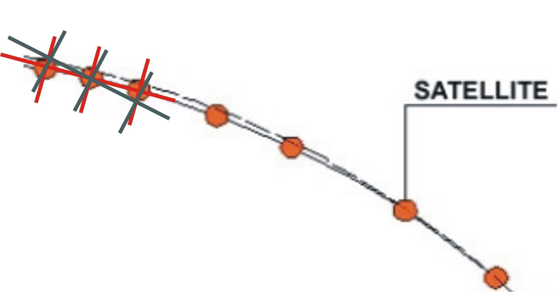

Just butting in. Going by skew tables for a dual or triple lnbf will definitely require a bit of tweaking.
Maybe this makes sense why.

Well then don't. 0.9 dB or more does wonders.
I have tried tweaking the skew in the past, and found no improvement in the signal levels using the DishPointer numbers. Using Dish's numbers, yes, I have seen some improvement. I suppose if the mount is not quite level, tweaking the skew could be helpful in some situations.
