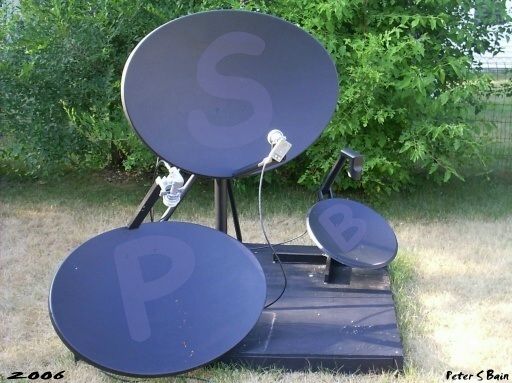

iafirebuff said:
I use 1 dish for G10 and IA7. I used a hose clamp to secure the lnb and a block of wood as a spacer. Thanks Iceberg for the tip!
Which dish are you using to get G10 & IA7 ?
I am using the Fortec 80cm dish, and have 2 Sadoun KUL1 .4 db lnbs. I have the dish aimed at G10 as that is my main one I watch. I then have the 2nd lnb strapped to the mounted one with a block of wood in between them. The one for IA7 is just a little higher than the G10 lnb. I will try to take pics this weekend.
