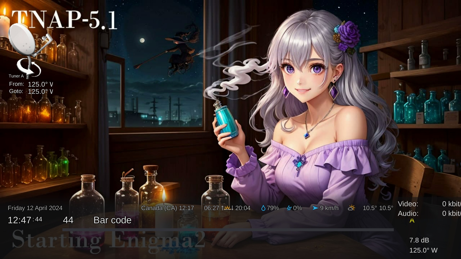

The new TNAP 5.1 test image has been posted by el bandido. You can do the installation via your Edision online feature to flash the new image into an available slot. Be sure to keep valid older images in the other slots just in case you need to revert back. Installation went well and the software has auto-install which means after installing you still have all your user files (satellite transponders, user bouquets, etc.) in place. You don't have to re-configure everything. This is a great time and effort saver.

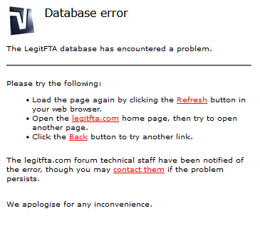

legitfta.com is not working for me now. I get:
This page isn’t working right now​
legitfta.com can't currently handle this request.
HTTP ERROR 503
Same results accessing the site. I tried with a couple of VPN locations,clearing cookies (cntrl f5) and different browsers. Looks like a server issue. Do you happen to know what is new in the 5.1 offering?

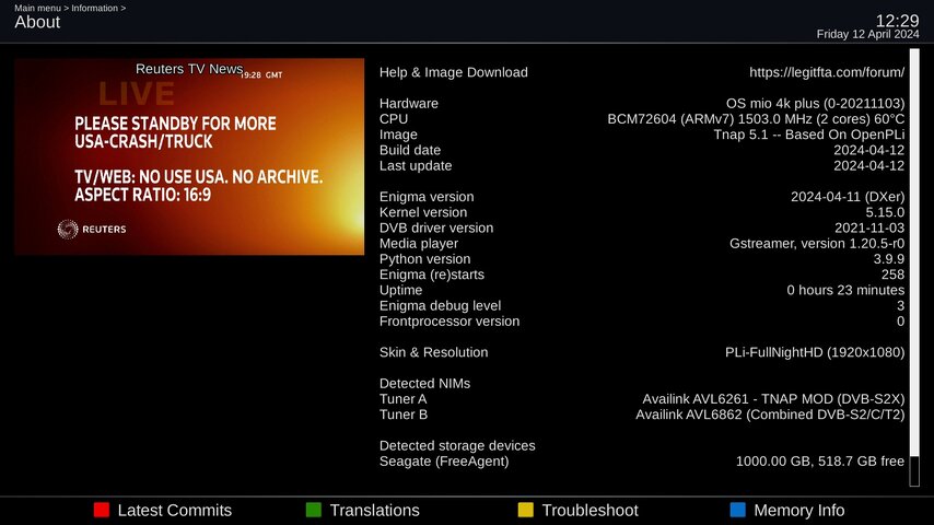

It is the same as going from 4.2 to 5.0 Some of the plugins like skins may not be installed if not available. 4.2 was python 2 and 5 ,5.1 are python 3. The settings file will work so you will get that and the channels installed.
5.1 is just 5.0 with more openpli updates. I think the feeds for 5.0 started getting mixed with some enigma2 changes so 5.1 was build to clean things up with new feeds for the new openpli updates. They both have the same python version 3.9.9 and same drivers. EB said some of the crashes in 5.0 were caused by a mixing of enigma2.
