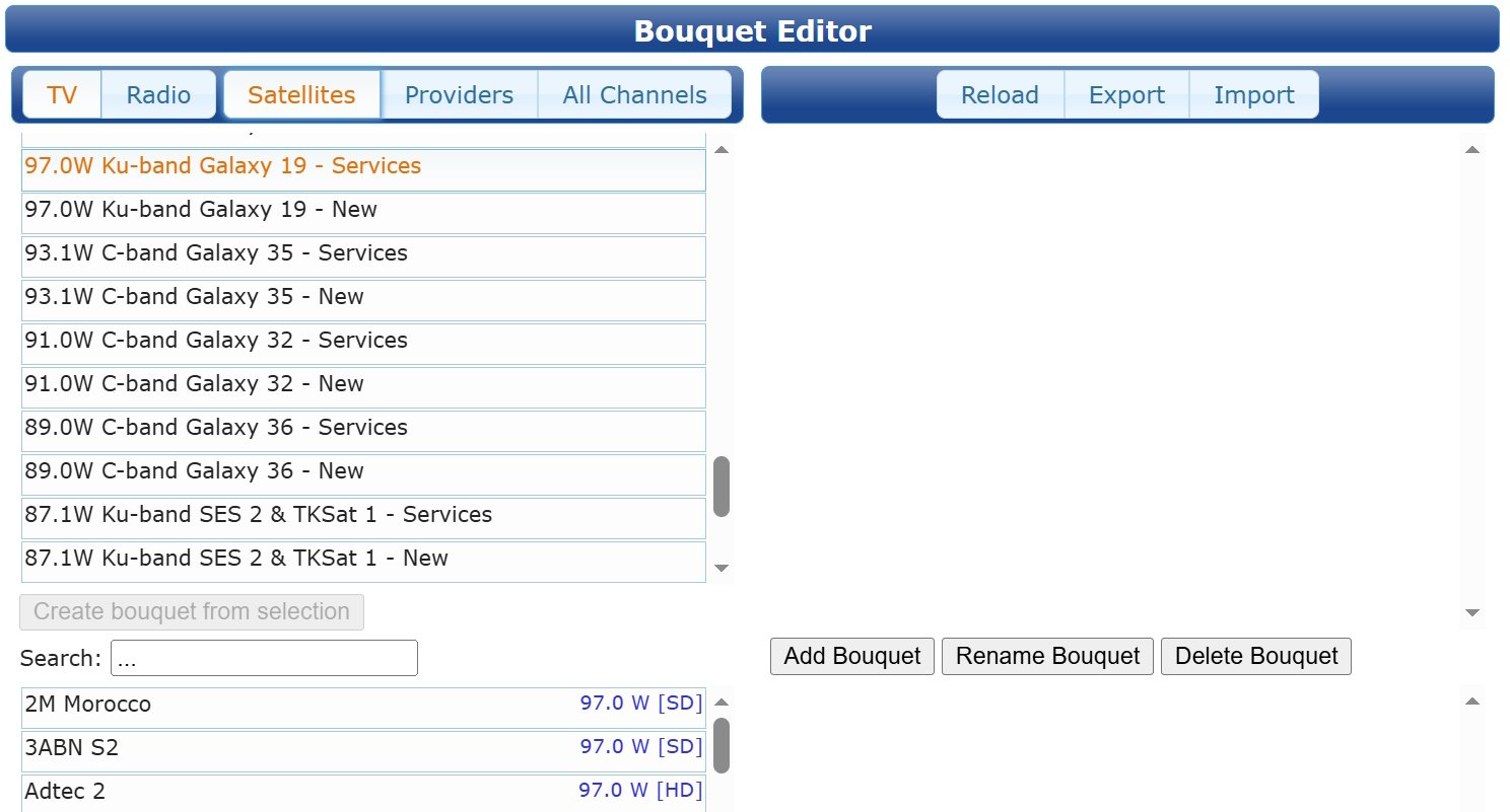

Using TNAP6 with latest updates and an Edision Mio+, I'm finding the Bouquet Editor is a little different. See image below.

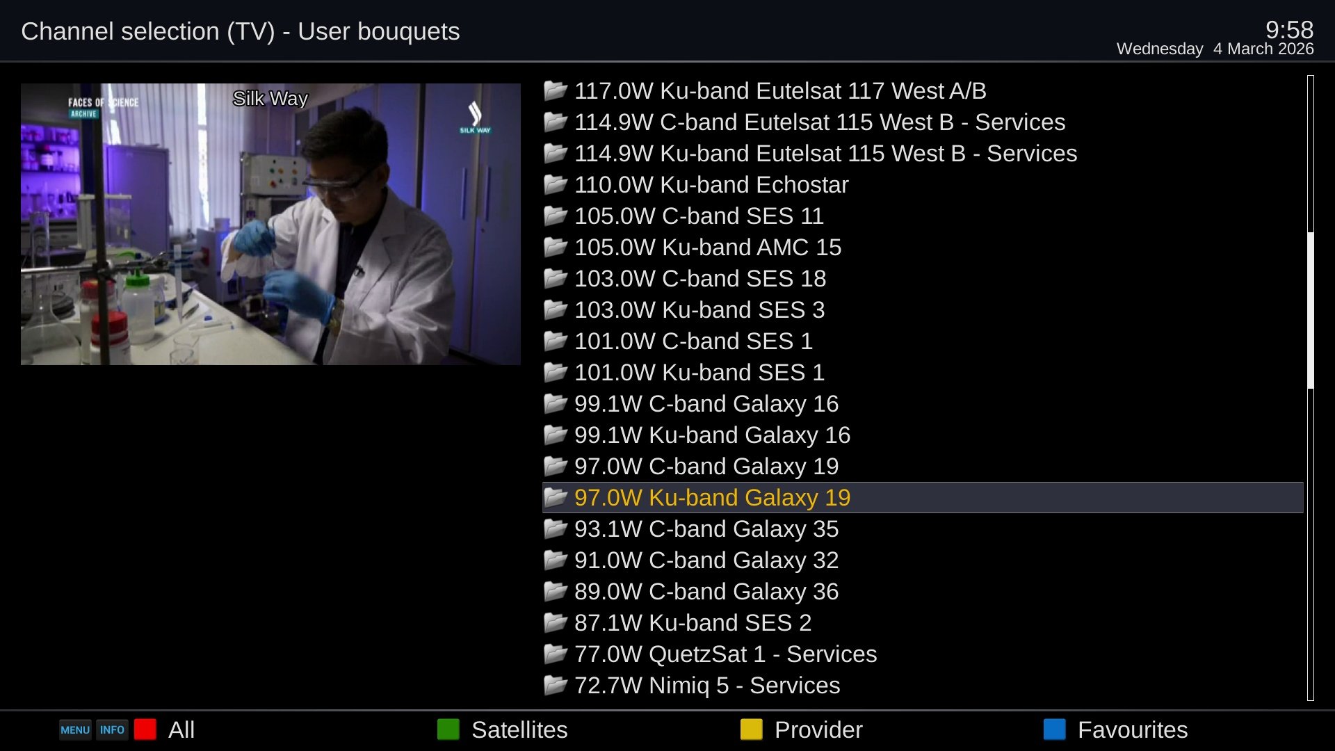

I have bouquets created for each satellite that I have scanned in. I can see them on my TV screen when using the receiver. But on the right side below, shouldn't there be the list of entries in the bouquet for 97W Ku? Then I can add or delete as I wish. But there's nothing there.
ADDED: I have a feeling the problem is a result of my not using the "Copy to bouquets" function that was introduced in recent versions of TNAP. I stopped using it since it didn't work correctly for me. So I manually create bouquets using the Edision receiver.

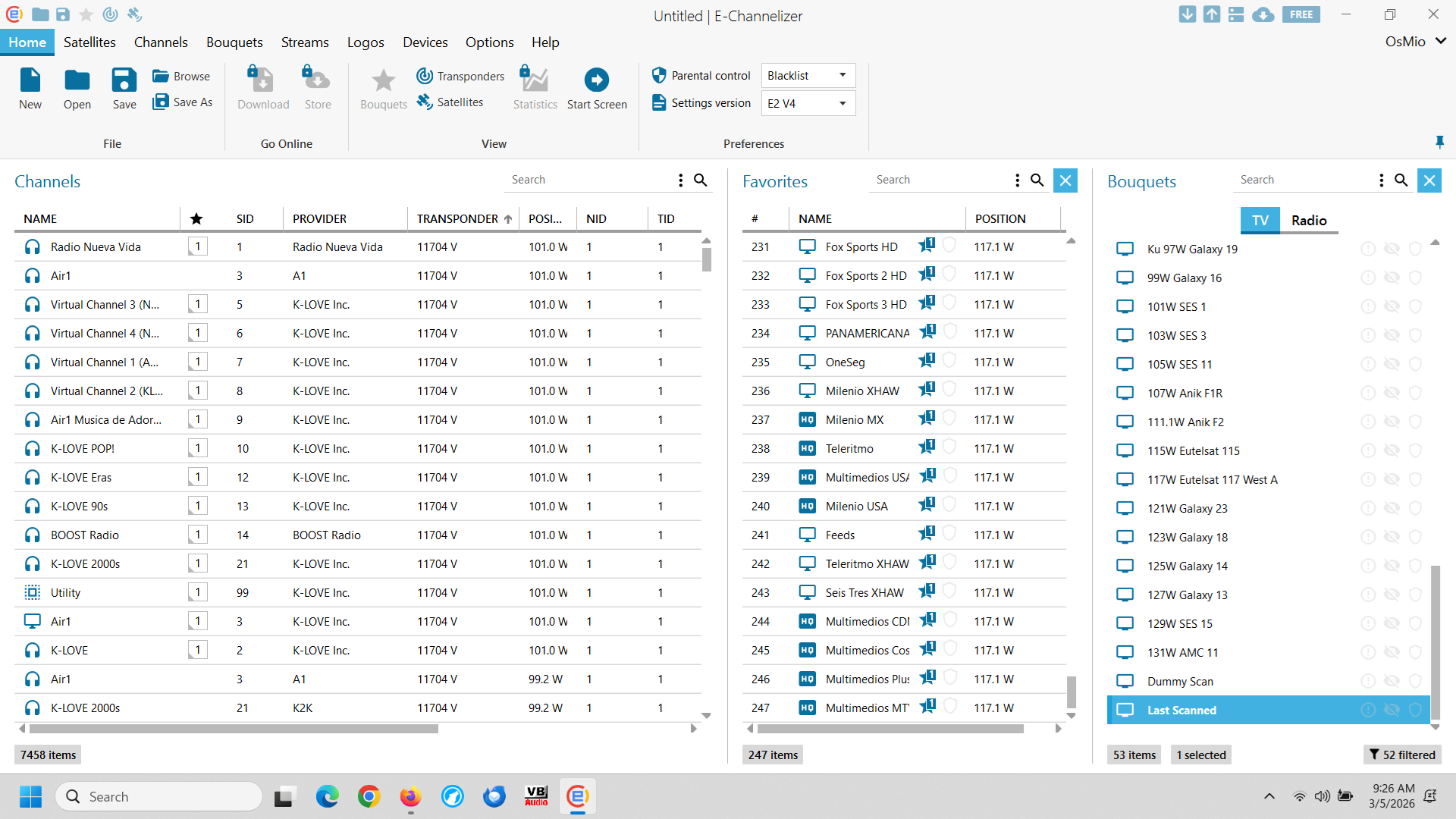

Don't know cybes. Haven't ever really used an onboard editor. Probably because of the whole remote left-right-up-down thing. Using an old version of E-Channelizer and have been for years. The free version. I know some prefer the likes of Dreamboxeditor and the likes. Onboard editors just seem a little bit "fatware" to me.
I like the ease of scanning a sat. and downloading it into my editor. Shift-clicking a group of Digicipher, Nagra, etc., channels and deleting them. Same for selecting and ordering channels into an easily created and named boo-kay.
Not even sure with an onboard editor how you deal with channels that scan in as Program 101 and are really something different when using the likes of a chart from tvro. Same for picons (sounds like someone needs a dental surgeon). Name the channel correctly, drag the picons from the chart to a folder and name it the same as your channel.
Easy. But I could be wrong.

I can use the Webif bouquet editor now which was my original problem.
Working with el bandido I've learned that this webif issue was caused by some corrupted iptv bouquets in my receiver. I removed the four bouquets in question and then I could immediately can see all bouquets in webif again.
In future, I will download new iptv bouquets in small numbers and check for any issues. If this problem reoccurs then I will just delete the recently-downloaded bouquets that are corrupted.
