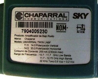

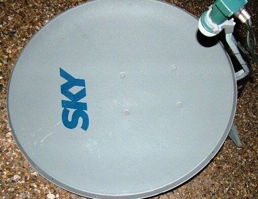

Will this dish and LNB get FTA satellite channels?
And if so is there a link for setup?
The Dish is 30" w x 34" high,

That is a good sized dish and will work fine for FTA.

With that dish and that LNB you will easily find one decent channel on 119W if you blindscan for FTA channels in the clear. There are other channels, but they are more difficult to find. If you want more FTA channels on other Sats, you will need to change your lnb to a linear lnb. Your LNB is a Universal LNB that receives circular signals.
http://www.satelliteguys.us/fta-mpeg2-faqs/52968-what-linear-circular-polarization.html
The op has a linear Universal type LNBF, not a circular. Disregard the previous post regarding the 119w satellite.
