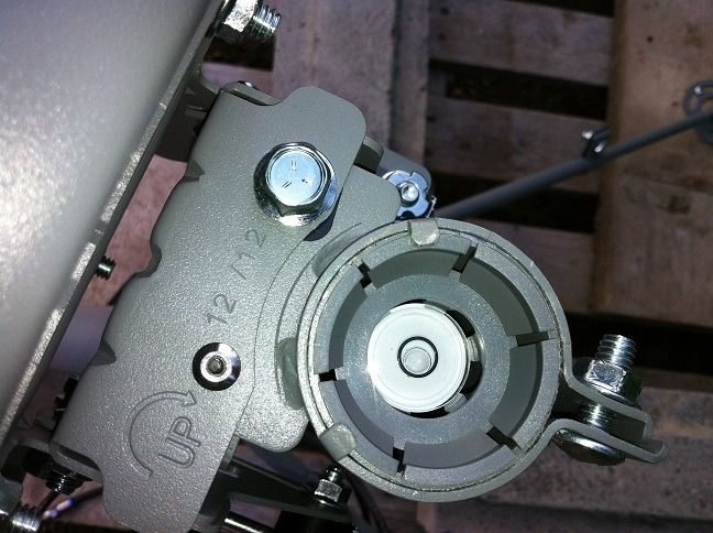

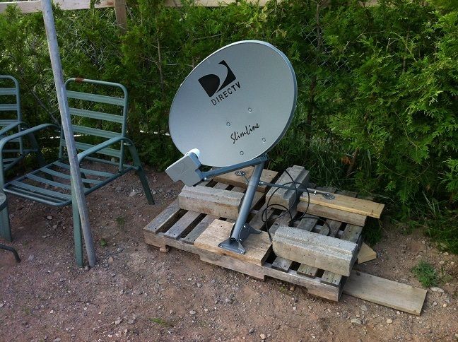

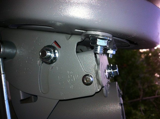

I am trying install a Slimline SL3 SWM dish at my in laws. They didn't want the dish on the house so I rigged up a platform ( pallet, weighted down with cement blocks) in the back corner of the yard. The elevation setting here is 27 degrees for Sat 101. I triple checked my mast was plumb on the platform both with my own level and the built in mast level. Tightened the arm braces down and checked the mast one last time and all was good. So I put the dish on the mast, still plumb according to the mast level and Coarse aligned (using super buddy meter) the dish with the pre set elevation. Nothing, played around with the elevation for a bit, and finally with the dish elevation all the way to the lowest setting I hit 99% on 101. Because the the elevation is all the way down, I can't dither because it won't go any lower.. Where did I go wrong, how could the elevation be that far off with the mast plumb, even if it wasn't 100% plumb, it wouldn't be THAT far off the elevation. The platform is very secure, not wobbly at all. Each cement block is about 70 lbs. Here are some pictures for a visual.

Your elevation is set to approximately 20°, not 27°.
Yes I realize this, I wasn't getting any signal level on my meter with the correct elevation, I had to drop the elevation down to 20 ( all the way to the lowest setting) and my meter shot up to 98%. My mast was plumb... so I realized later today that the platform was not leveled so I tilted the mast down and adjusted the elevation accordingly to around 27 degrees. I got 98% and followed the dither instructions, plugged my receiver in and get the 771. Rested the setup, dish 17 ( SL3 and SWM) no signal acquired. I had single cable running from SWM LNB to power inserter and 1 cable out from Power inserter ( IRD PORT) to the receiver (H25). No signal on all satellites. Any ideas? Do I Have to use the splitter/ switch even with 1 cable?
