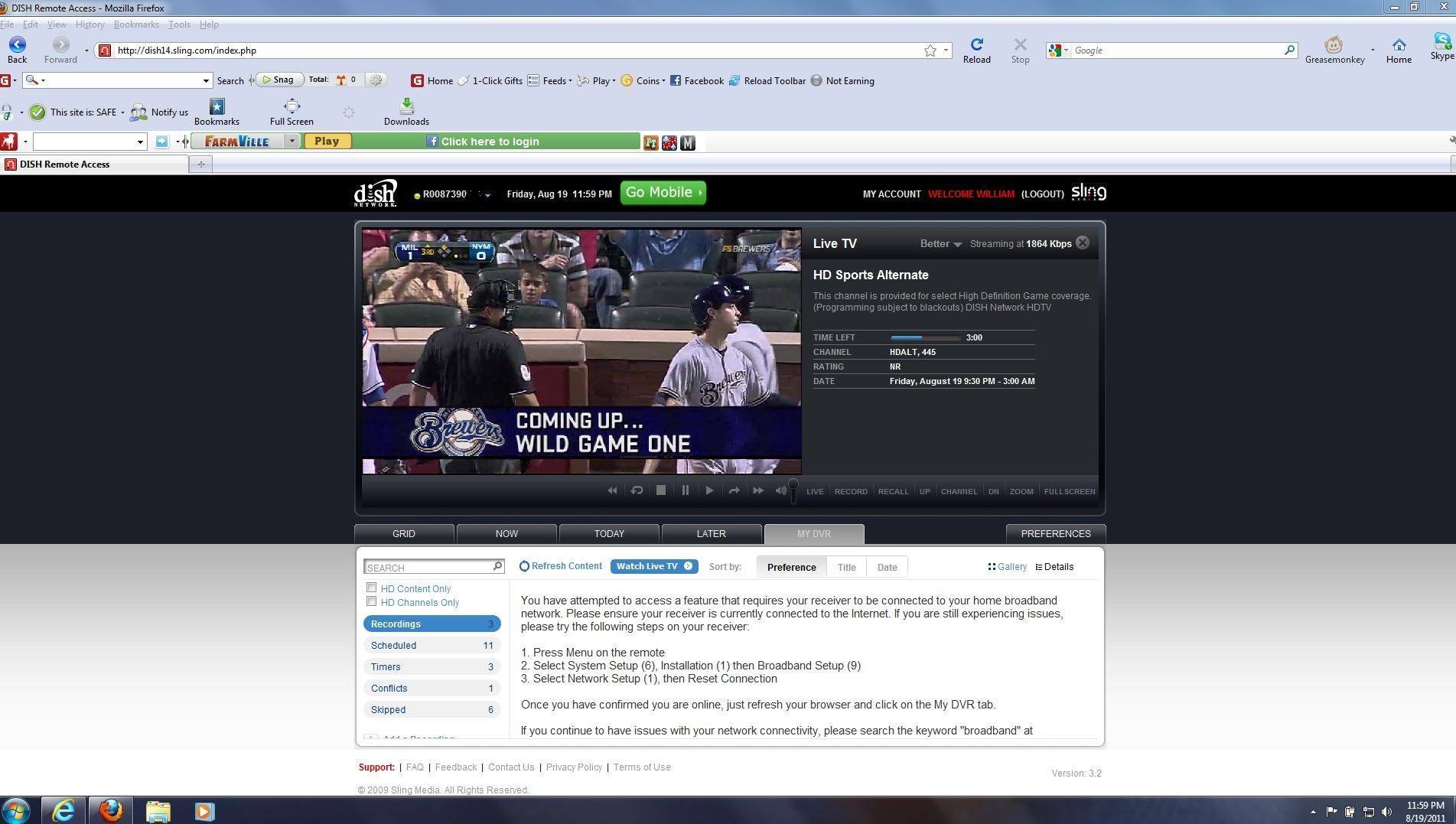

This is the message I recive when I try to go to the reciever settings. And I am guessing there is no way to fix that away from being at home which makes no sense since people use these away from home mostly. I did reset my reciever, when I got home, made sure it says it is connected to the internet which it was...I even tried using the usb wireless adapter that dish sent me to see if that would work and none of it is working. I think my wireless strength was 43-48 so I would think that would be good enough. Prior to that I had it going through a homelink adapter and that would work sometimes and sometimes not. Now the DVR doesnt show up at all with the USB wireless adapter. I have a new one coming to the doorstep tomorrow, will see if that reciever plays a little better. The odd thing is is that my secondary reciever was showing as on-line when I was going through the homeplug adapter but would not show my primary with the sling adapter on it. Maybe the 722k works better for on-line? If this doesnt work I do not know what to do. I actually bought the sling adapter for $100 and now feal jipped out because everyone else is getting it for free, and I have had nothing but problems from the get go. It maybe works one out of 3 times when away from home. And my laptop is more then fast enough to get the data and process it so it isnt that issue either...I7 proccesor, windows 7 64 bit with 4gb of ram. So I am just at a loss right now. Hoping new reciever will fix it. If not, I guess I wil have to eat the cost of the adapter and be just another unsatisfied custermer of dish.
Your receiver is currently offline. If you would like to reconnect to the Internet, please try the following steps:
1. Press Menu on the remote
2. Select System Setup (6), Installation (1) then Broadband Setup (9)
3. Select Network Setup (1), then Reset Connection
Once you have confirmed you are online, just refresh your browser and click on the Receiver Settings button.
If you continue to have issues with your network connectivity, please search the keyword "broadband" at www.dishnetwork.com/askdish for additional assistance.
