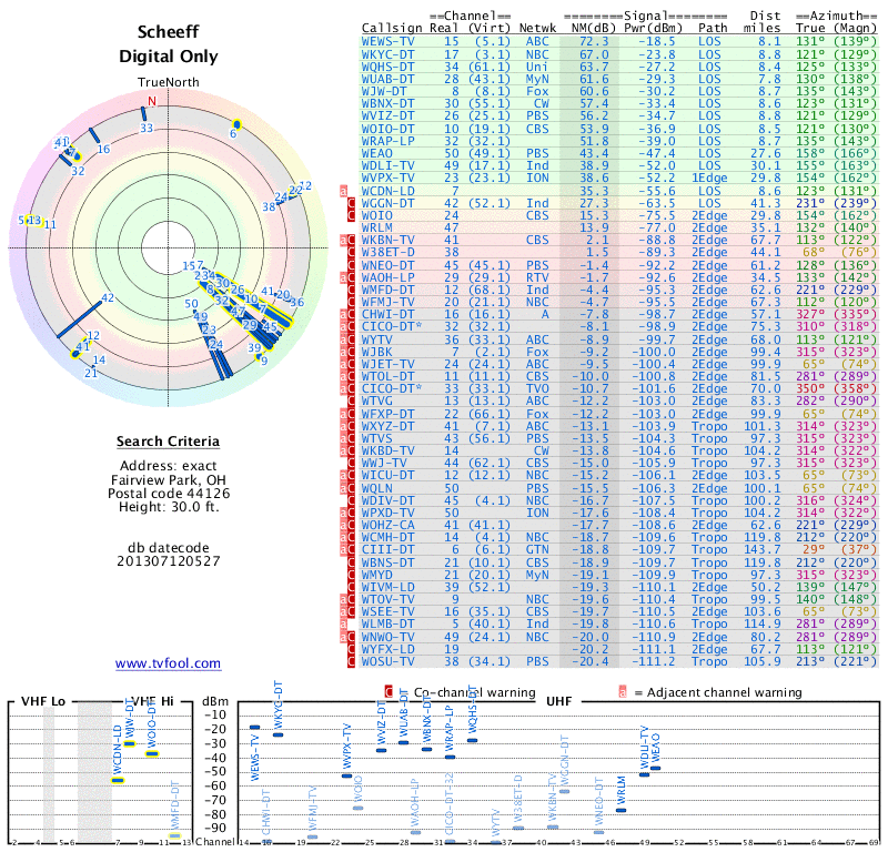

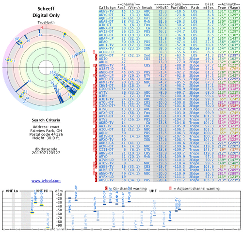

I have a friend that just got married and moved into a small apartment. He is OTA only, and I was trying to help him get an indoor antenna that would work. I gave him my old RCA ANT150, a loop/rabbit ear combo with a built in amplifier. He gets all the main Cleveland channels save one, WOIO, which broadcasts on rather low power on channel 10, and also has interference problems from another channel 10 on the other side of Lake Erie. Unfortunately, with many antennas, including that RCA, VHF response is rather poor as most channels move out of them for the digital transition. Are there any small indoor antennas out there that still do good at VHF-hi that are not particularly expensive?
His apartment does not really have an exclusive use area for an outdoor antenna, so the solution needs to be indoor, and look somewhat decent. The good news is he apartment is on the east side, while transmitters are to the south east, so he does have a window that faces them, but a bit askew.
TVFool analysis attached.

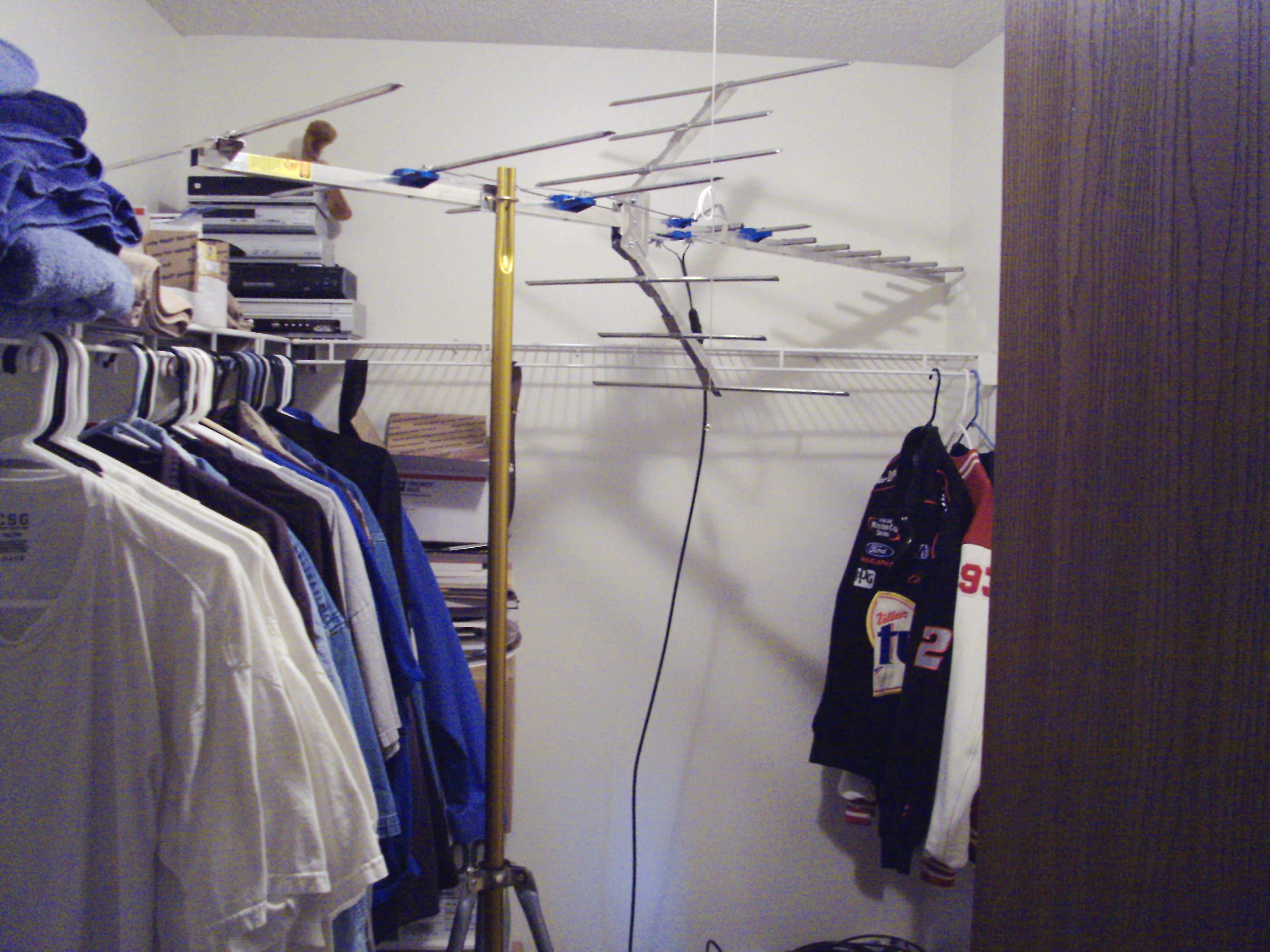

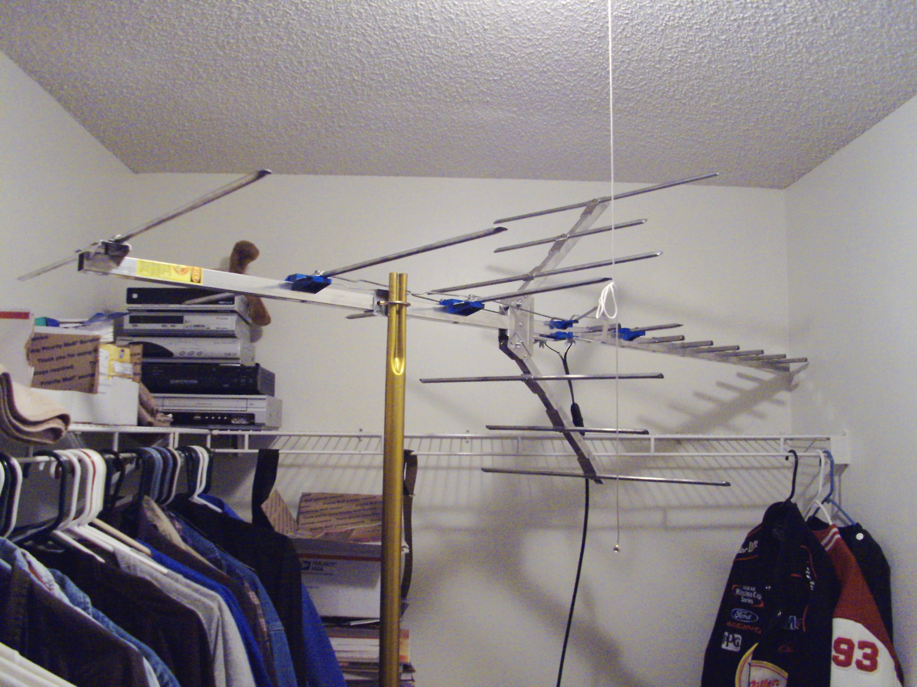

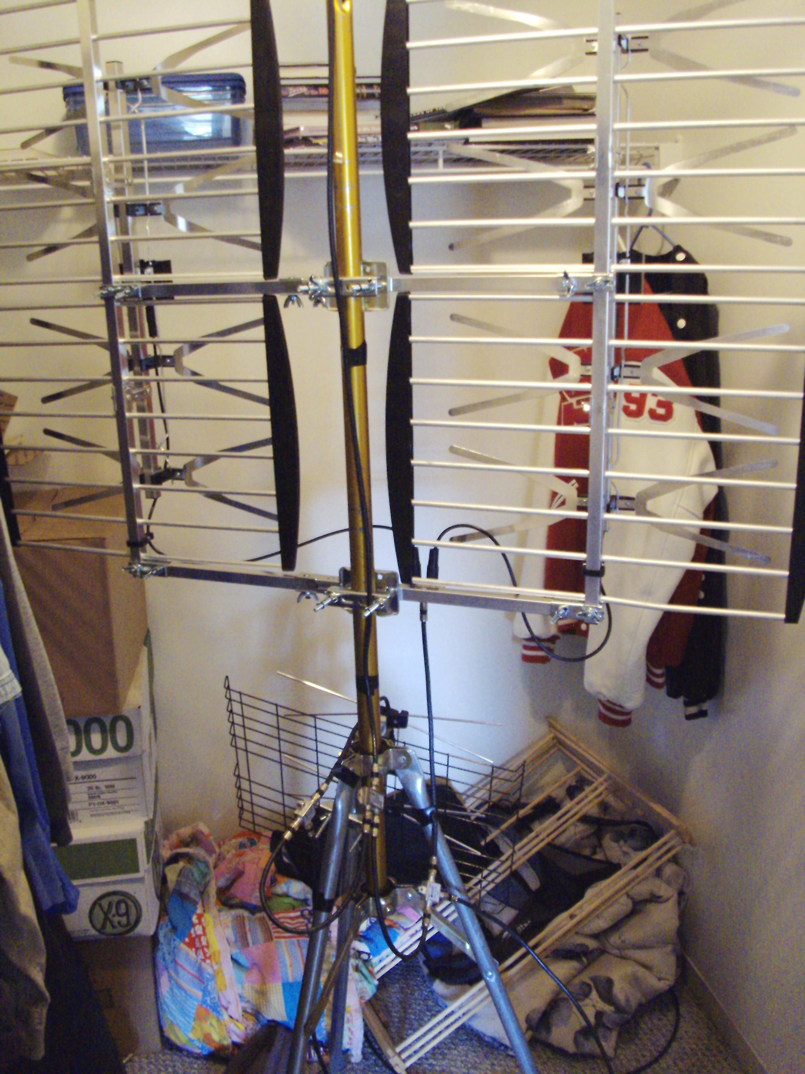

so it took me a month to get around to it......but here it is
If you have a high ceiling, it would make a good art-deco piece for the living room.
Is that what they called a coat hanger antenna in the fifties?
Neat way to get reception and hide it from the living area.
Is that shelf behind it metal or plastic? Also, how do you not bang into that, taking out your shirts, jackets and what not? :confused:

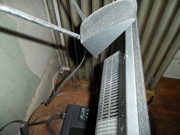

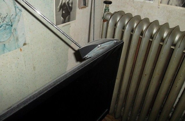

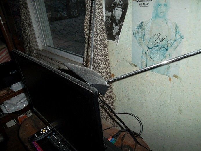

As for VHF channel 10, I know the feeling here in Hartford/New Haven. Somehow, an ancient VHF-rod only indoor antenna works for me! I have it near a south-facing second floor window. I get the UHFs surprisingly well (with Rattlesnake Mountain in Farmington 5 miles away or less, I had better get them!). WTNH-TV (ABC) channel 8 of New Haven uses channel 10 for their digital. As for the antenna, it's needed, since it's the only way I get the locals in HD anymore. Thanks for nothing Comcast! :rant:
(P.S. The antenna is resting [barely] on the top of a 24" Toshiba LED HDTV from 2011.)
metal.
its up about 7 feet in the air. Also its depth perception as I can get to most of the shirts in the closet. There is a good 5 feet of shelf space that you dont see
As for the jackets...they are for show. If you notice one of them says "93" on the arm......you figure that one out ;)
nah. The tripod method works fine. Its far back enough it doesnt bother me. I can get behind there with no issues. Just did it yesterday to get the xmas decorations

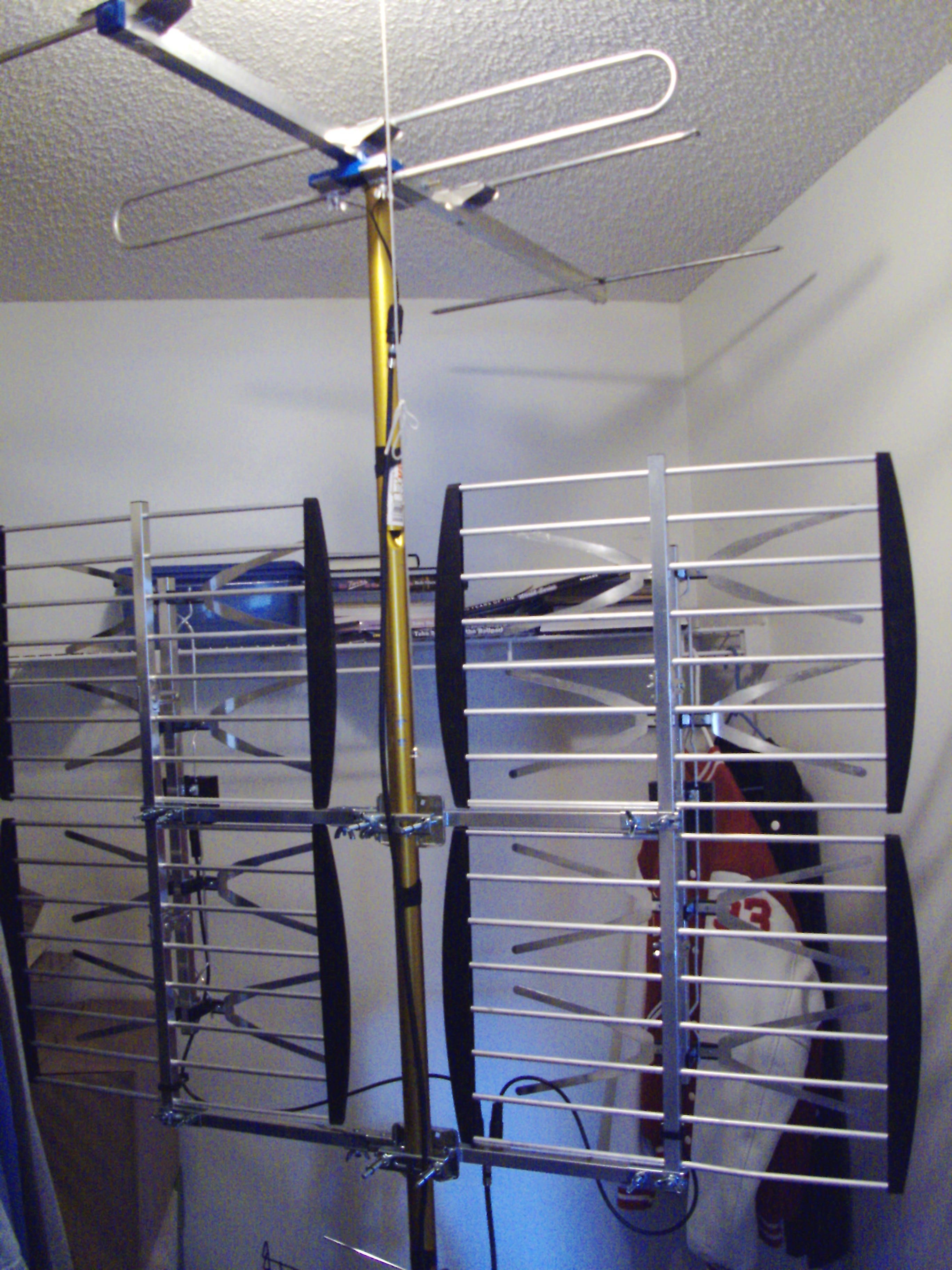

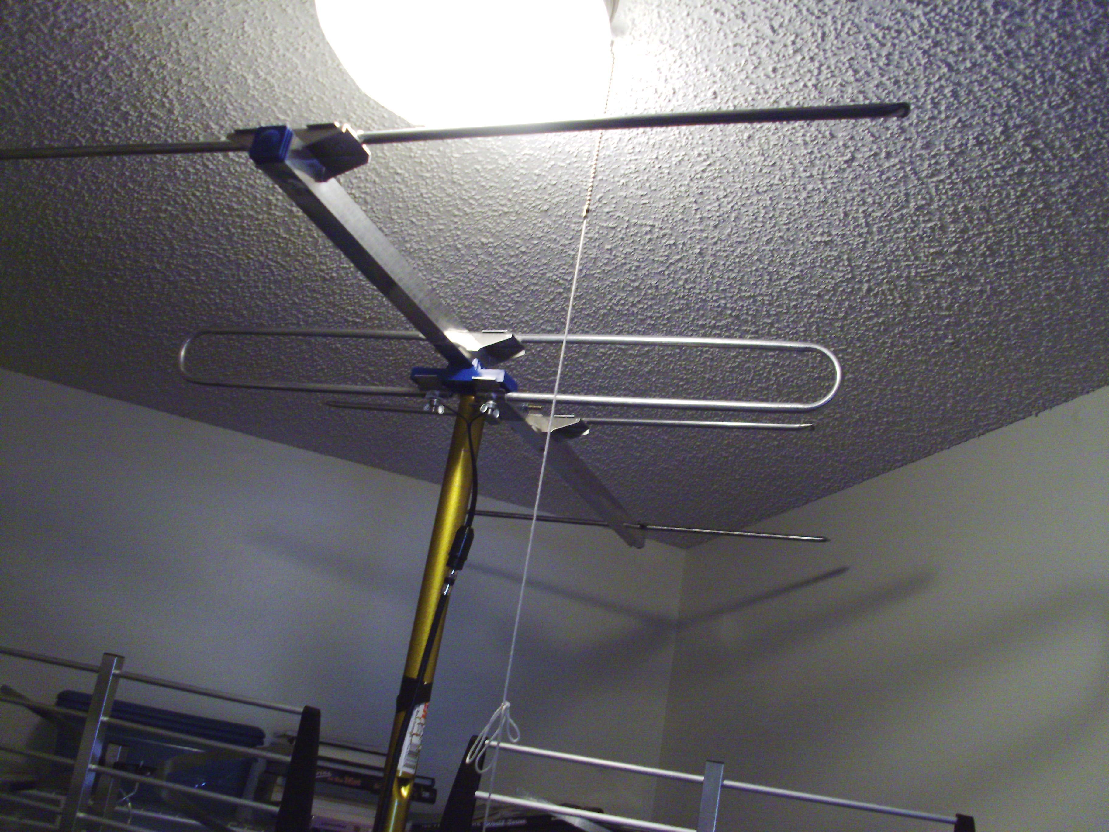

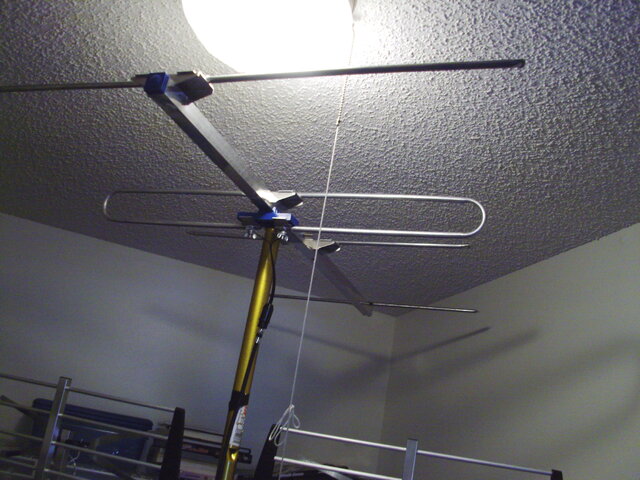

Here was my updated "antenna in the closet" setup. Reason it "was" is this is in my old place (I'm no longer there)
Got a 8 bay antenna as a special from Solid Signal and a separate VHF antenna. And if you look close yes the one element of the VHF is gone. I had to cut the antenna back about 6 inches to fit it in the closet.
At the bottom is a simple 2 bay UHF antenna. The VHF antenna is split. Each output runs to a UVSJ. The 8 bay is one on the UVSJ's which went to the Tivo. The 2 bay is on the other and went to the bedroom tv. Why not split the 8 bay and go to both tv's? Well I got the 2 bay UHF at goodwill for 1.99 so why not use it :)
