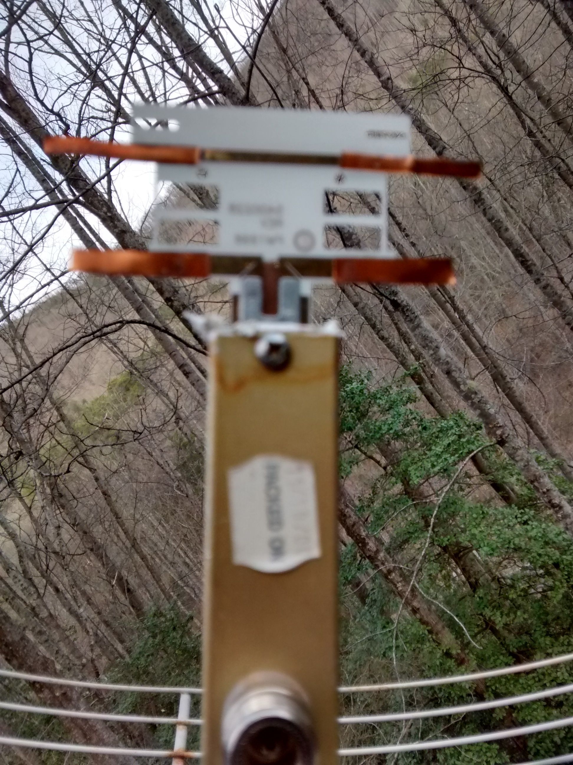

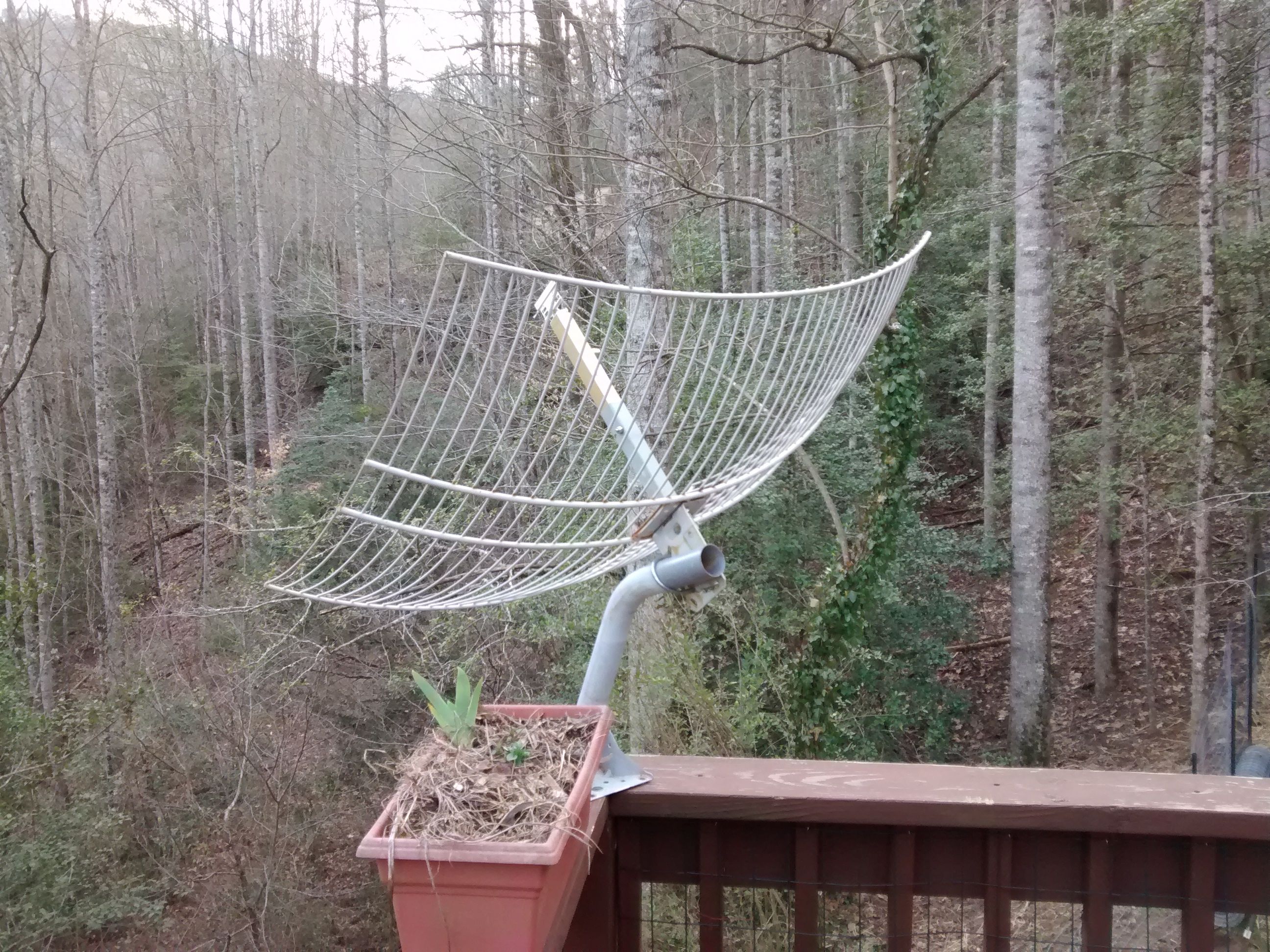

Well...I can now say that the SDRPlay hooked to the feedpoint of my mesh dish will/does work. I am seeing a signal right where
it should be. I have recored a IQ file for Joe and wait to hear back on if he can decode the EMWIN data from it. My dish is a Laird DC24(40x24")...I had
an extra feed and cut it open and reworked for 1700Mhz(was just a dipole inside). This dish was for a PtP wifi link, but the Laird spec sheet
said it would go down to 1700Mhz(close enuff!!)

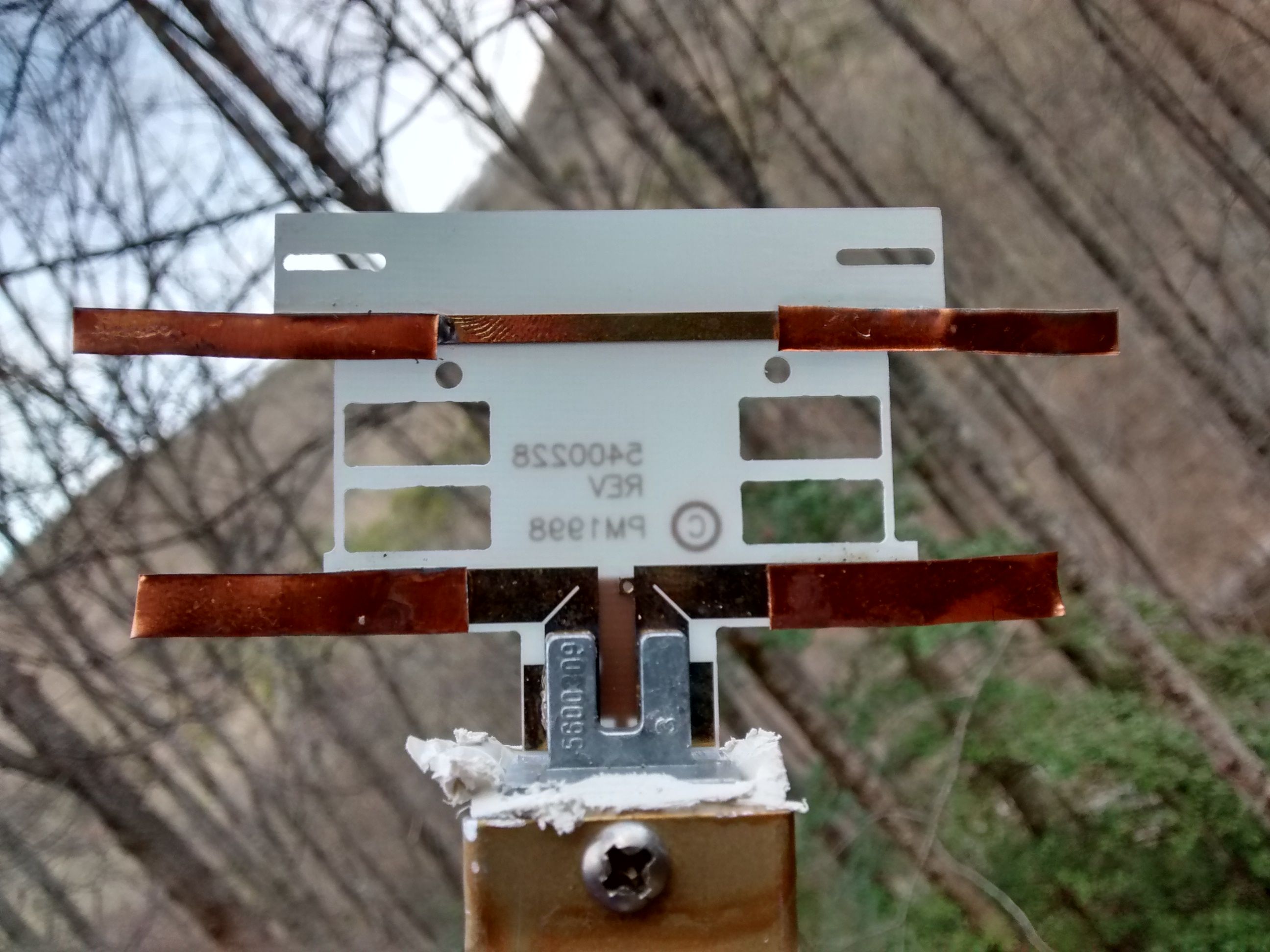

I did not try it with the 2.4Ghz feed....since I had an extra one. I will take a few shots this eve when
I get home and post for ya. All I did was use a thin strip of copper flashing(cut from a sheet I had) to add length to the
exsisting dipole and reflector.(It is just a etched board inside, so I just soldered the extra copper to it then trimmed)
I really don't know if the signal I am RXing is strong enough...as I have never done this...but it does "stand out" from the background
on the waterfall. I don't recall exactly...but it seems it was 100-150K wide????Maybe??.
Trip - KT4WO

OK...here are a few pics of my setup....very, very basic and as it turns out,,,,about 2db too low.
Reactions: k.r.
I will try rotating the feed/dish/house to get a better signal....But Joe said what I have now is not enuff.
If that does not work.....then time for a LNA or ......BUD.
Trip - KT4WO
