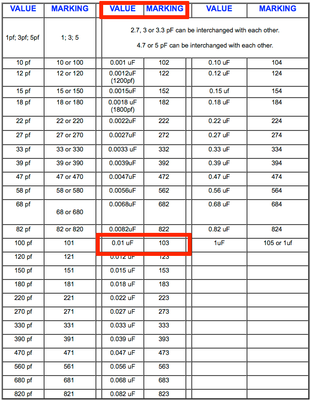

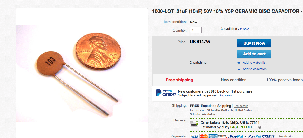

So I googled for pictures of a .01 uf capacitor as called for in the help file.
One of them took me to an ebay auction which claims to be selling such a critter but in a quantity far above any normal person would ever need.
But the main thing is, it showed me what the markings should be as I go on an impossible scavenger hunt through old castaway electronics long forgotten.

So I'm looking for little discs marked 103. I'm not planning on buying thousands of these things on ebay so no worries.
I'll just keep digging until I find one in something I've already got here.
Yep. I just found something that confirms the markings I'm looking for.. :D

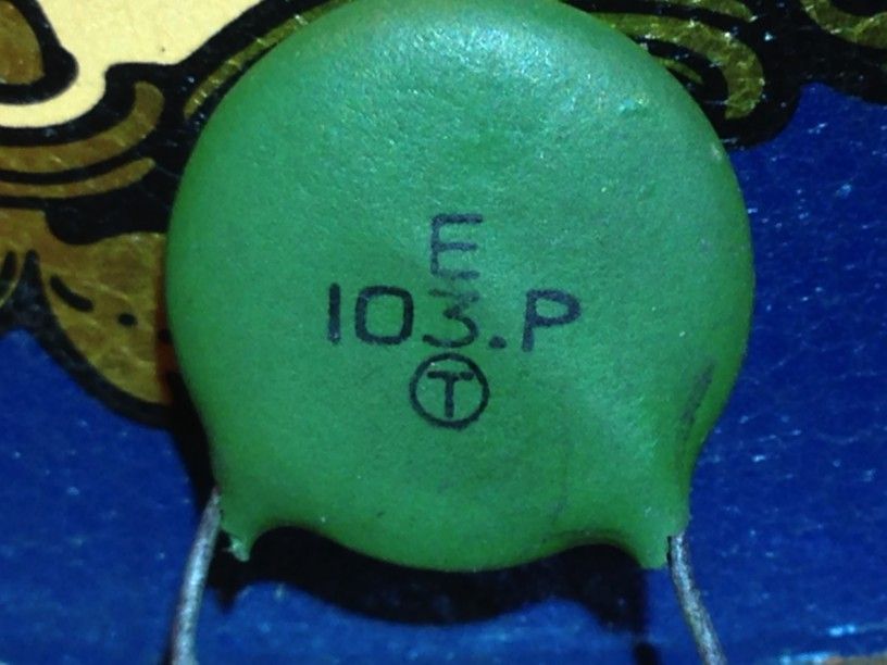

Will this work? I found it in an OLD VCR..
It has the 103 on it but the letters and the circle T are a boondoggle to me.
Yep that will work.

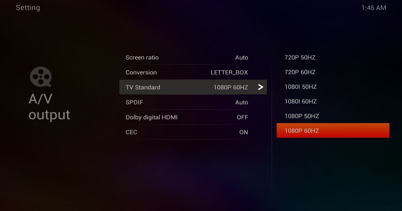

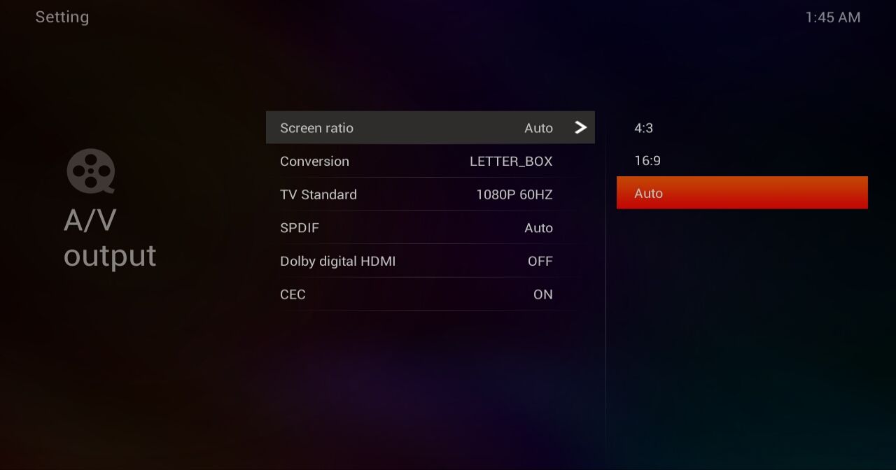

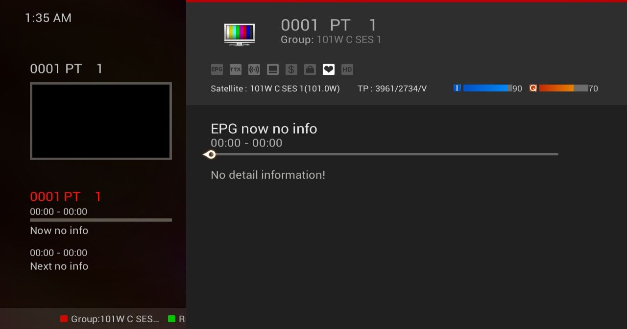

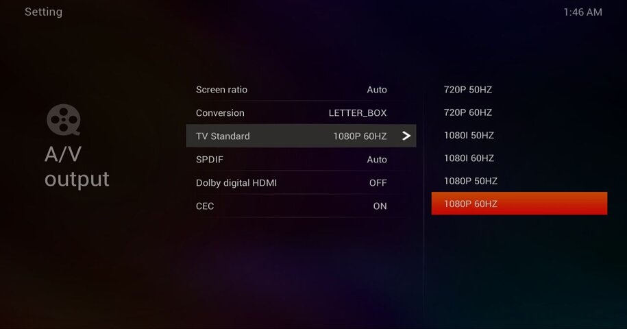

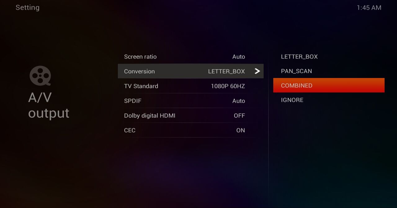

The signal and quality levels seem just fine. I checked to see if there are any apps running in the background and there are none reported.
I thought it might be the screen resolution, so I changed it from 1080p to 720p. No change. Still not a fluid display.
No other channel does this.
I've tried all the different screen settings like the letterbox option and whatnot..
GET SCREEN SHOT 0.2435638562310487.jpeg GET SCREEN SHOT 0.44502525799907744.jpeg GET SCREEN SHOT 0.8427410717122257.jpeg GET SCREEN SHOT 0.863388161174953.jpeg
It really makes watching anything on that channel quite unpleasant. I'm baffled.
