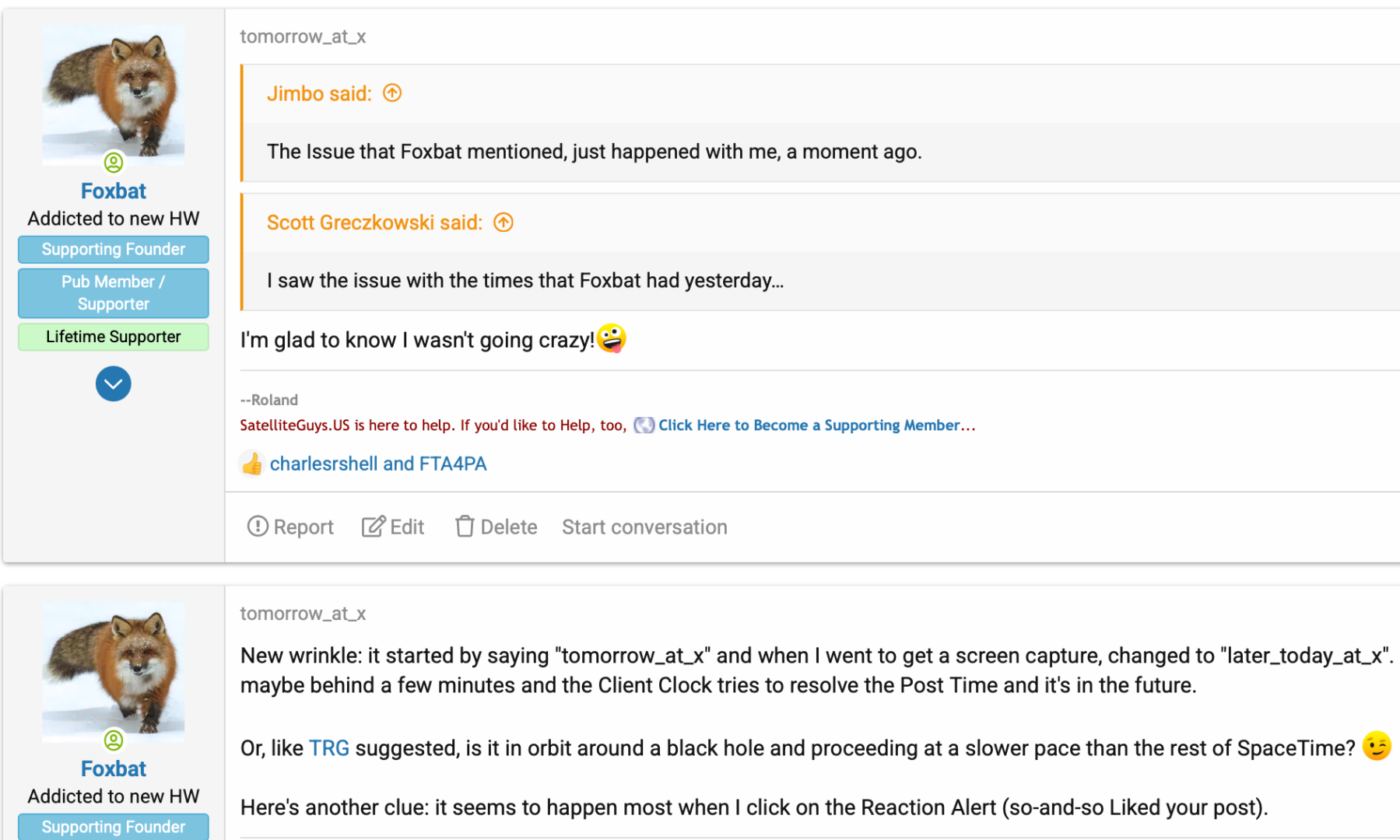

Yes, a refresh made everything here good as well. iPadOS v18.3.1 and the current Safari client. I figured it was a weird caching issue...
edit: and it just happened to my new Mac Mini with Sequoia v15.3.1 and Safari Version 18.3 (20620.2.4.11.5). A Command-R to refresh and it had the correct time, not "later today at x" (which sounds like Elon and his DoGE Hounds have injected a redirect to X)(JK)

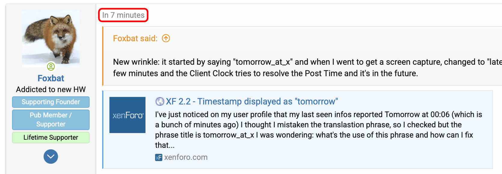

New wrinkle: it started by saying "tomorrow_at_x" and when I went to get a screen capture, changed to "later_today_at_x". It definitely sounds like a Clock issue. Is there server in the right Time Zone? Is the board properly set up for Eastern Standard Time? Or, is the clock maybe behind a few minutes and the Client Clock tries to resolve the Post Time and it's in the future.
Or, like TRG suggested, is it in orbit around a black hole and proceeding at a slower pace than the rest of SpaceTime? ;)

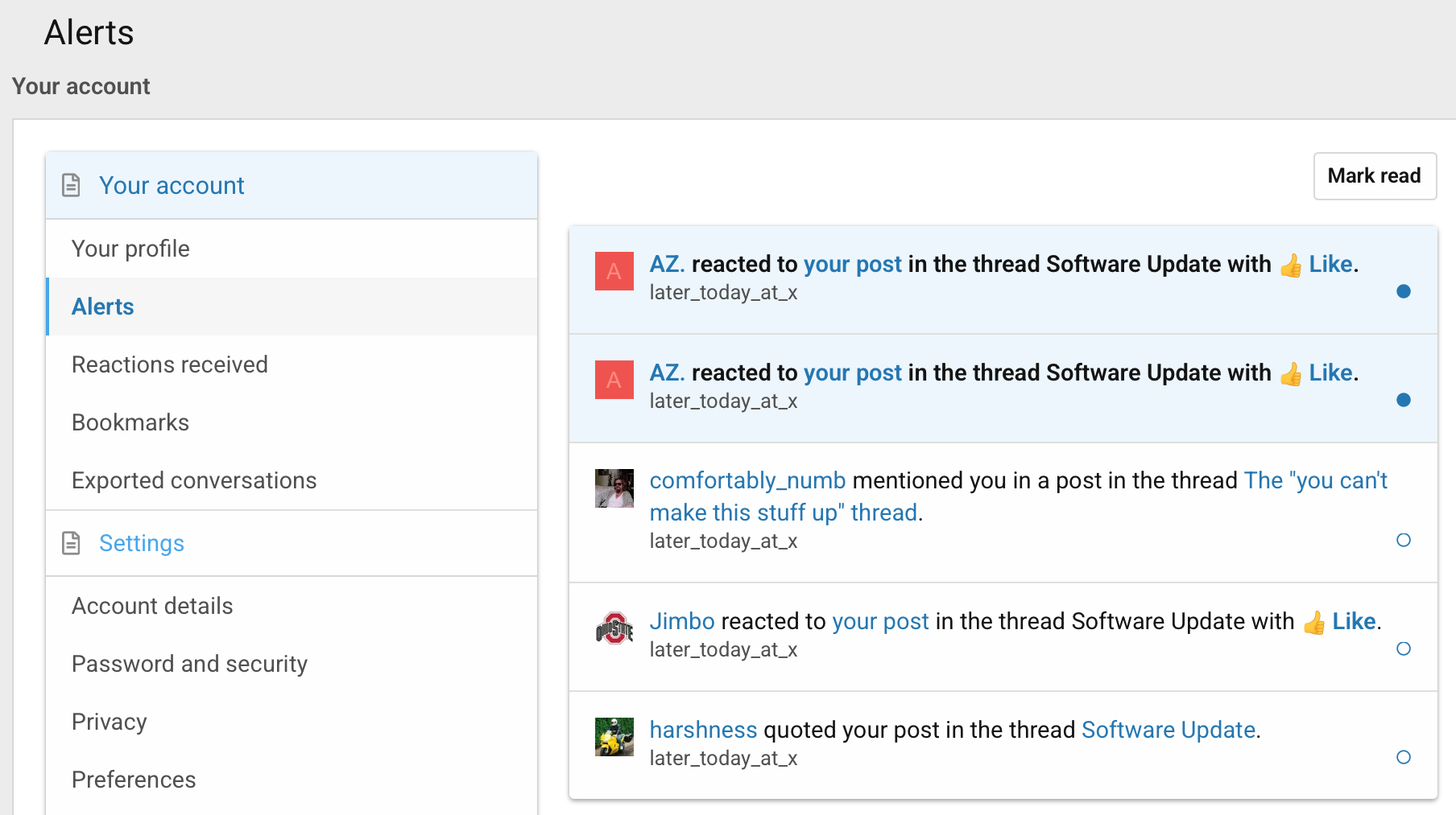

Here's another clue: it seems to happen most when I click on the Reaction Alert (so-and-so Liked your post). See:

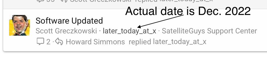

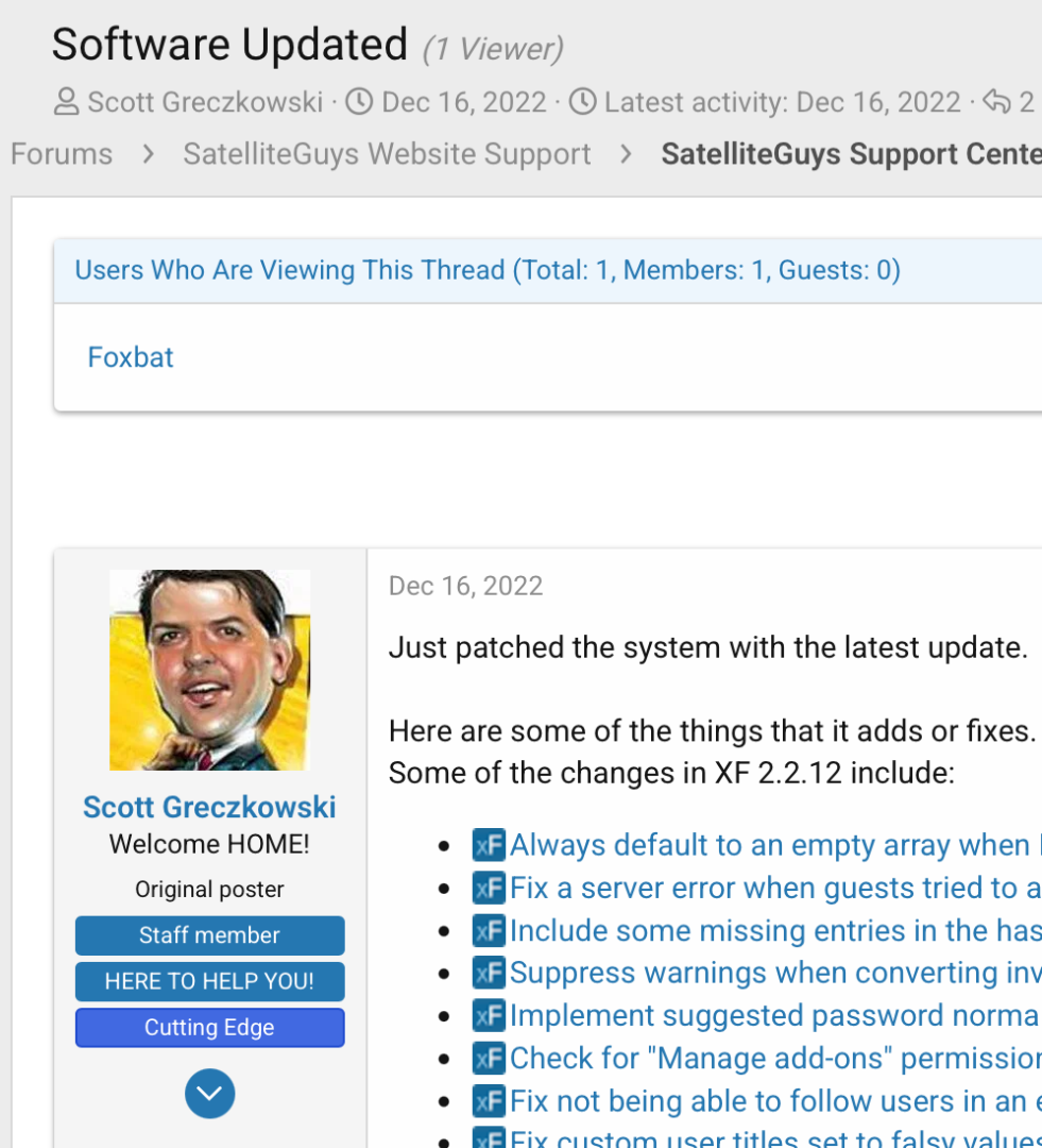

Down in the "Similar threads" section, I looked at one of the similar threads which was from December 2022, so items from years ago are showing up "in the future".
