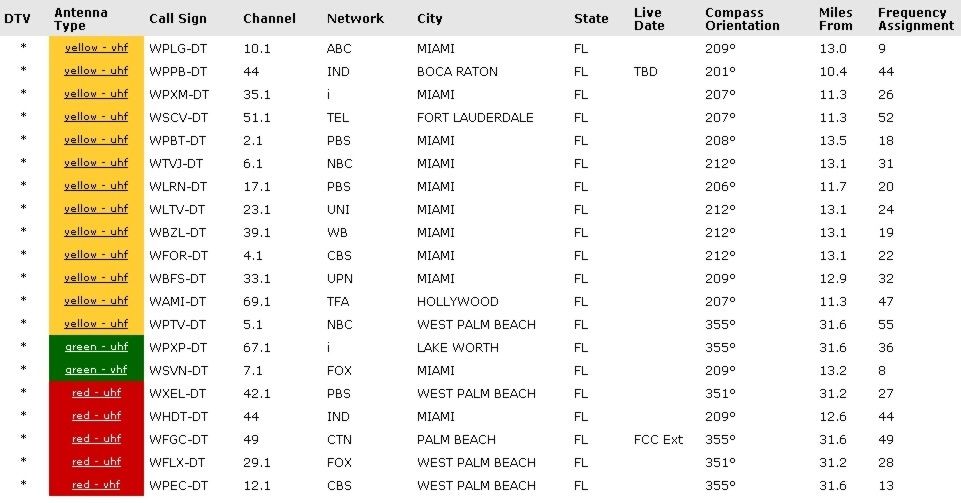

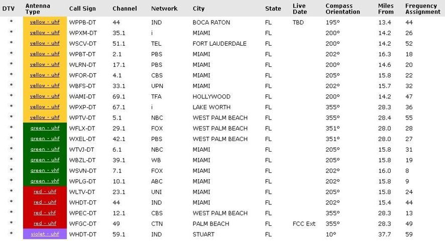

I have friends and relatives in the Palm Beach, Jensen Beach and Key Largo areas that I helped. What is your zip code, what antenna, and what heading, are you trying to use now. I used 33304 for Oakland Park, FL (correct?) and got these results. You are in one one those areas I love; covered with signals and mostly under 20m. Are you wanting everything you can get, or wanting to aim at one specific city; reception-wise?

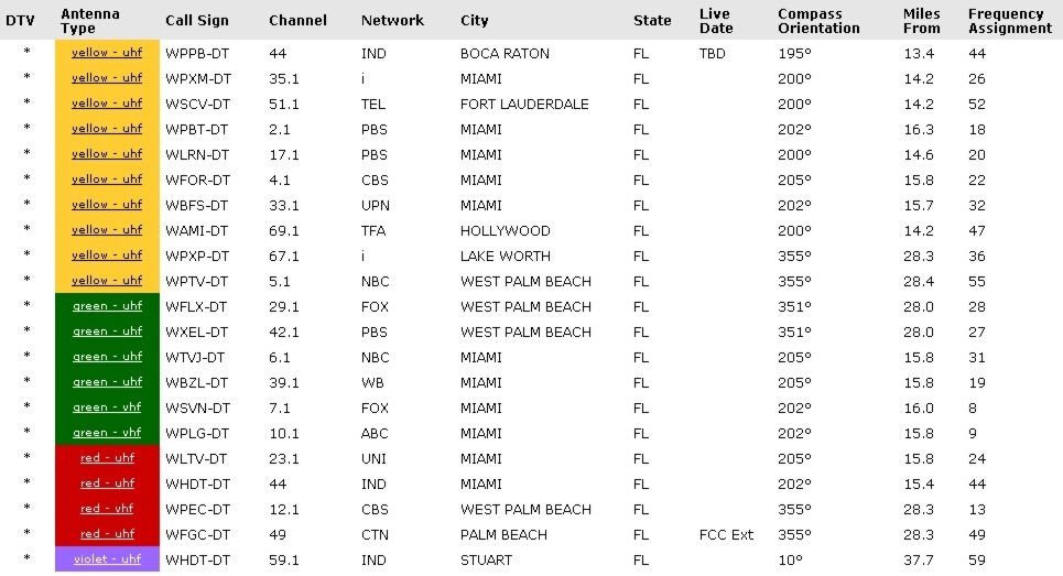

You only have 3 VHF channels and they are VHF HIGH, so you should have no worries. TONS of signal around you, all within 14 - 28 miles. I am not thrilled with any DBS provided OTA antenna, and you can almost alway get better for less money on your own. BUT be 110% sure to check your reception on all channels before you sign off of the install and let them leave. Also watch where and how they install; speak up at any point if things are not going the way you want. You want that OTA as high as possible; at the roof peak, or on the chimney if you have one.
Antennas Direct V21
Winegard HD7080P
Winegard PR 7015
Winegard PR 7000
Channel Master CM 3016
Channel Master CM 5646
Channel Master CM 3677
Channel Master CM 4221A (maybe)
