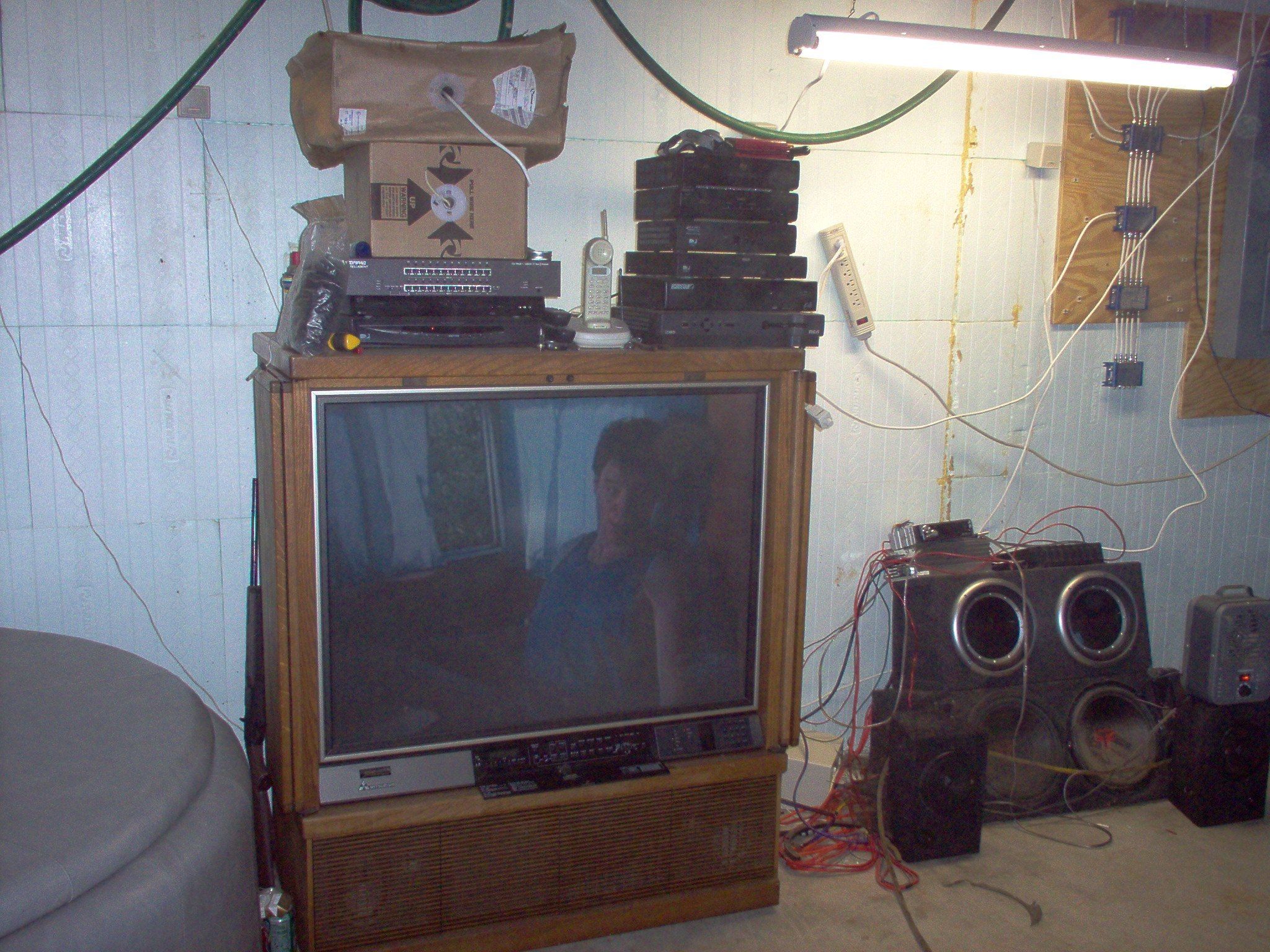

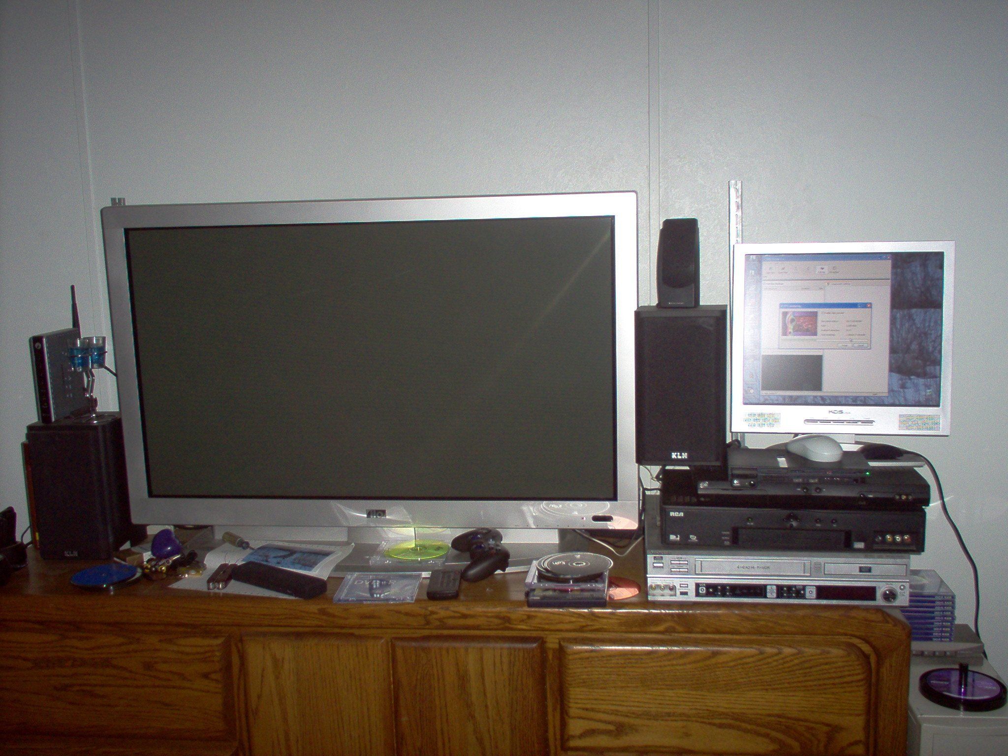

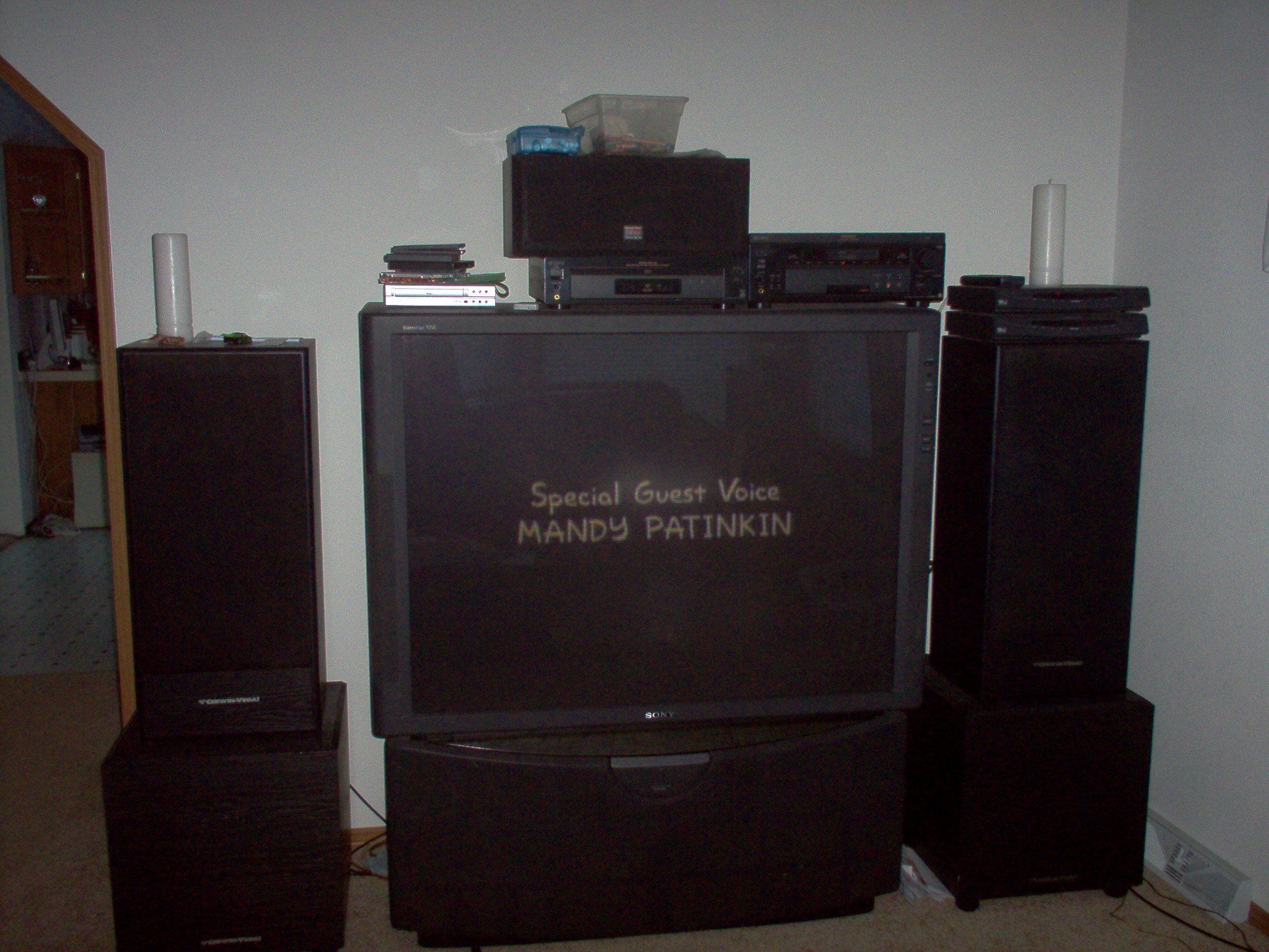

my tvs so far
I finally got around to taking photos of some of the tv systems. No nothing is complete and its a mess from moving in still but the important thing is their hooked up. The first pick is my baby, its a sony da90esg rceiver, dvp700 dvd, xbr hd digital 53" projection tv, re-6 center, l7 bookshelves for rears, and cerwin e312 towers with sub-150s (15" 200 watt self powered subs) up front. the plasma is an Ilo 42" in the bed room . and down stairs is the old faithfull 45" mitsubishi(cerca 1989) Sorry wireless glitched and the pics didn't load.
