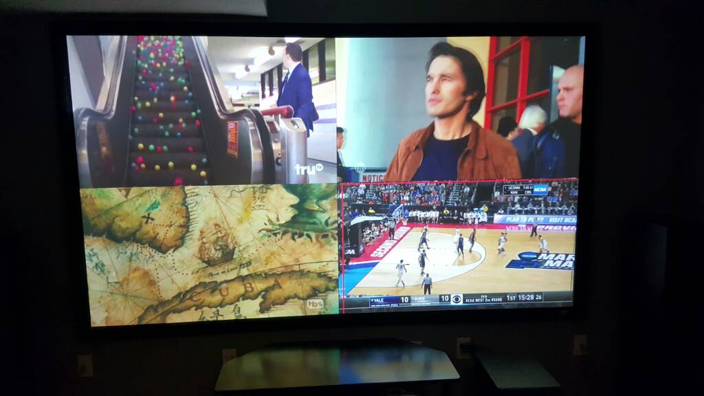

Add me to the audio dropout list. I don't have an optical cable so I used red/white and that worked. I didn't see this reported yet... Anyone else seeing the red box that indicates audio mis-aligned? Does this on all four boxes.
