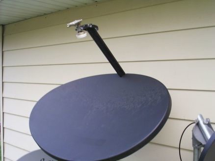

Here is my 40" P* dish upside down, working with that right now for low elevations.... In the picture its at around 28º elev.
So Pete
would it be better to try and find the satellite with the dish right side up first if I can tilt it far enough and the set it up the other way after?
Dave
Usually yes, well thats the way I do it. Trying to find a way to get this dish attached to my truck now :)
