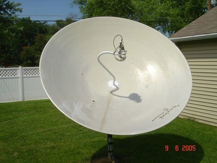

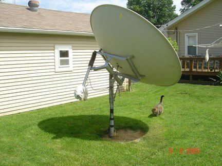

I don't want to steal Diamond Jim's thunder, but I found the pic of his spun aluminum dish
Damn that still is a sexy dish

that is a very nice dish,I have not seen one of those around,but if I do I will try to get it.the motor on that thing is huge,I would hate to have to replace one or those,I would have to take out a loan LoL.
