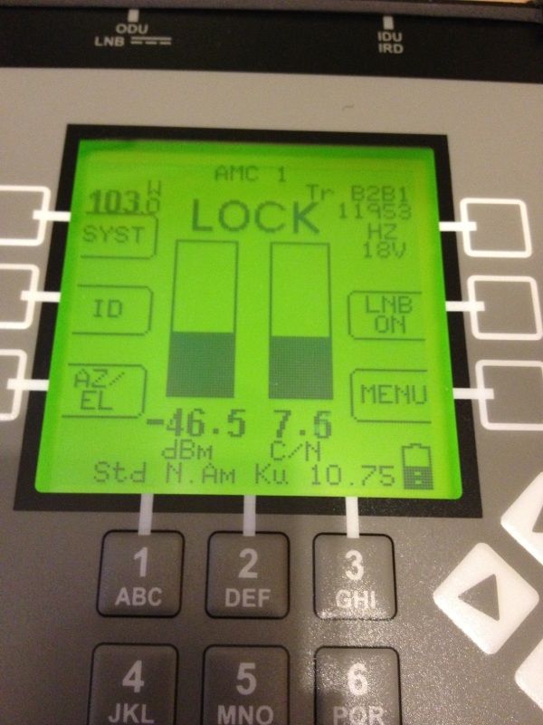

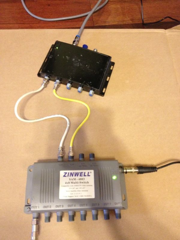

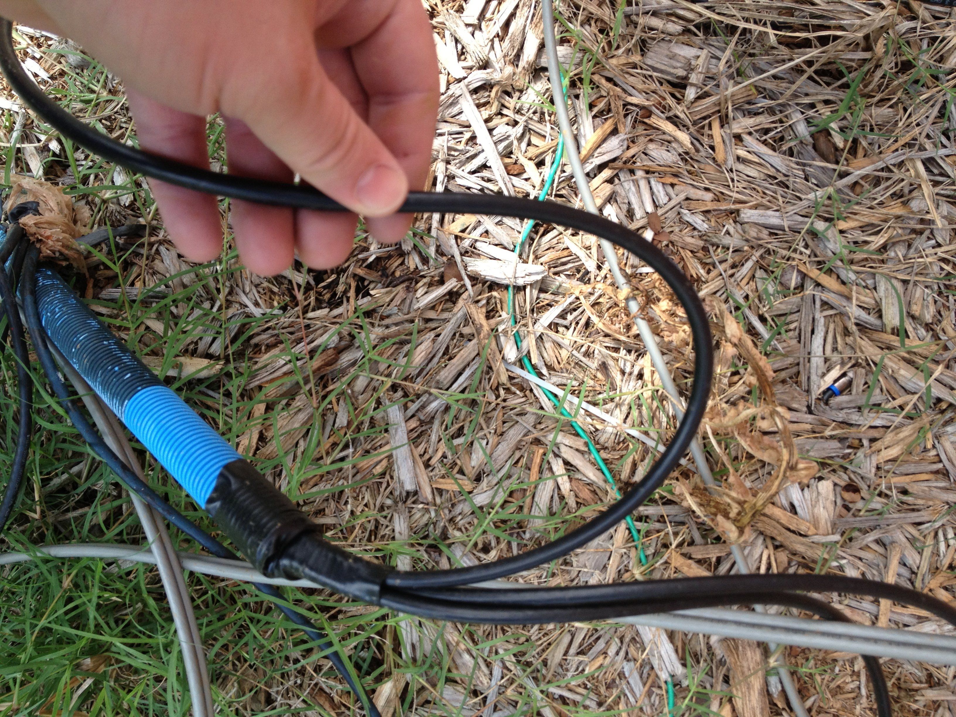

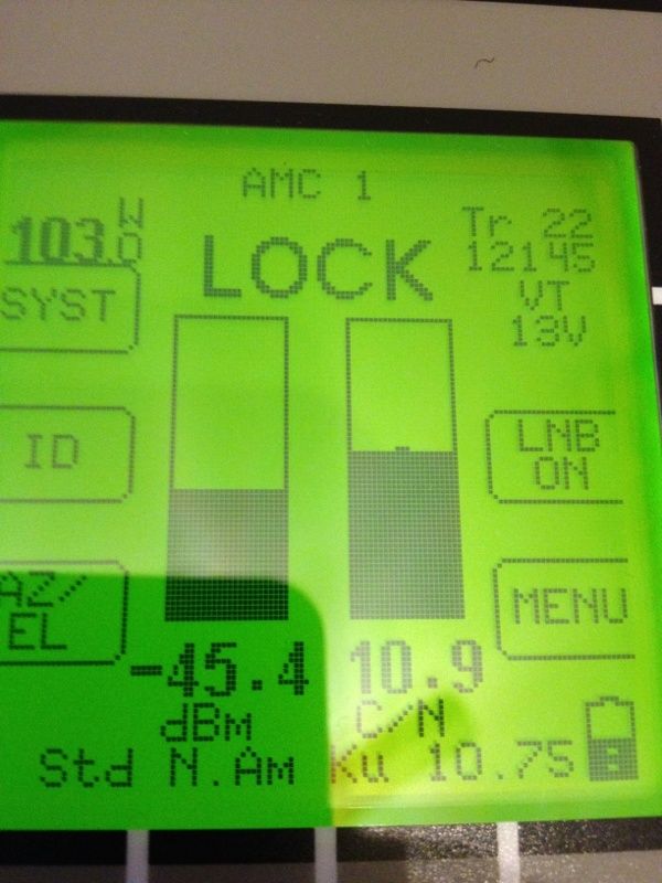

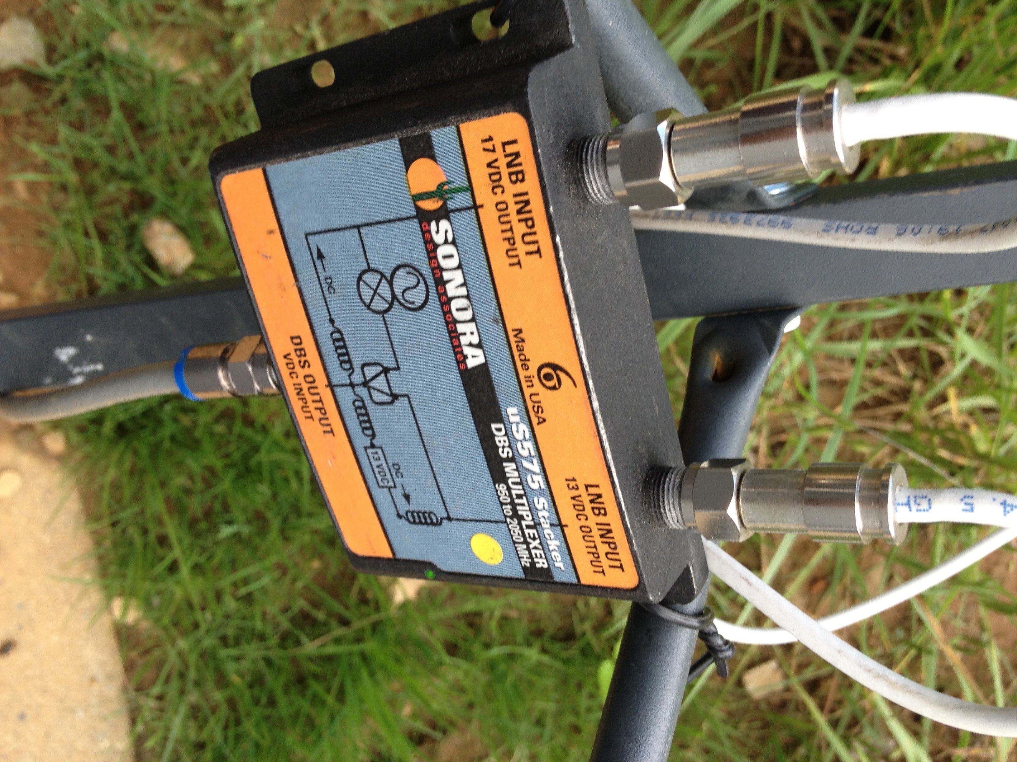

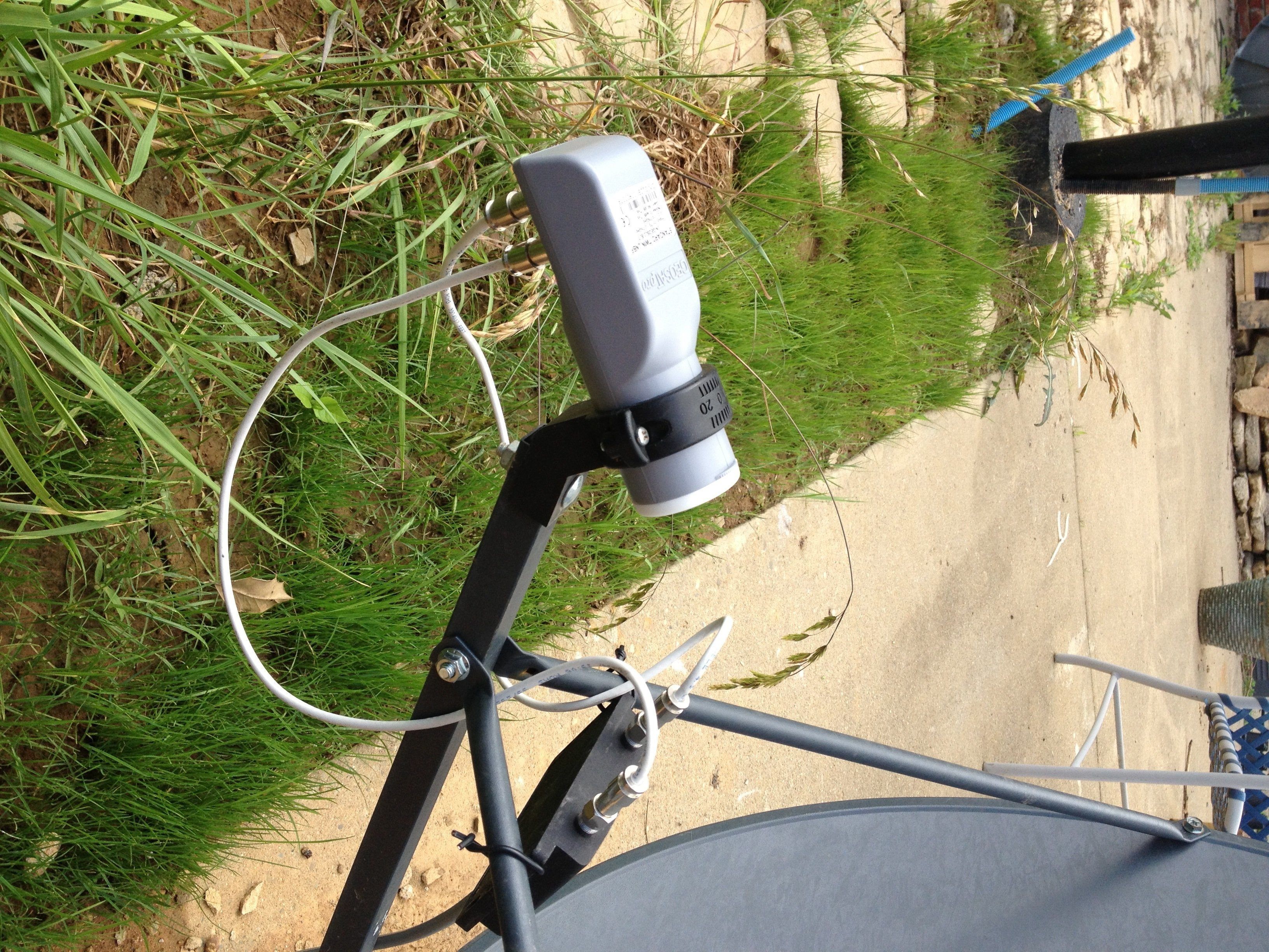

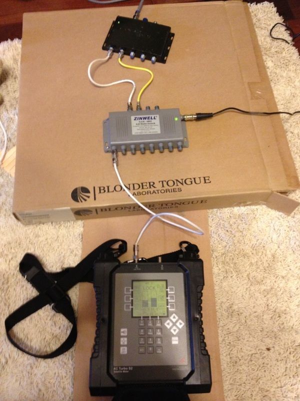

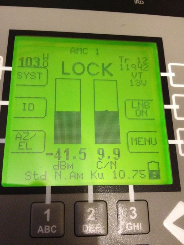

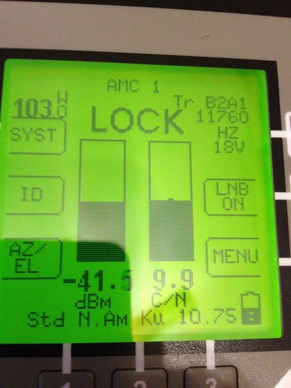

Have you ever been in a situation when you needed or wanted both H and V but only have one RG-6 for use? Ah what about band stacking well that's a great idea however good luck find a band stacked lnbf without ordering from across the pond. So I was thinking boy would it be nice if you could stack a normal dual port lnbf. I'm happy to say I found some gear that will do it check out the pics I have a video and more pics to post.

yup they use those in MDU setups for Dish and Directv. We have a few here in the complex :)
They work pretty well

SatelliteAV said:
PAL20 @ $89 + uS575 @ $149 = "I think I will run a second coax"! :D
What if u can't run another cable or sending over fiber and want to maximum the wave. :)
Other side.
Black box = Sonora ?? (Will update tonight)
4X8 switch (powered)
