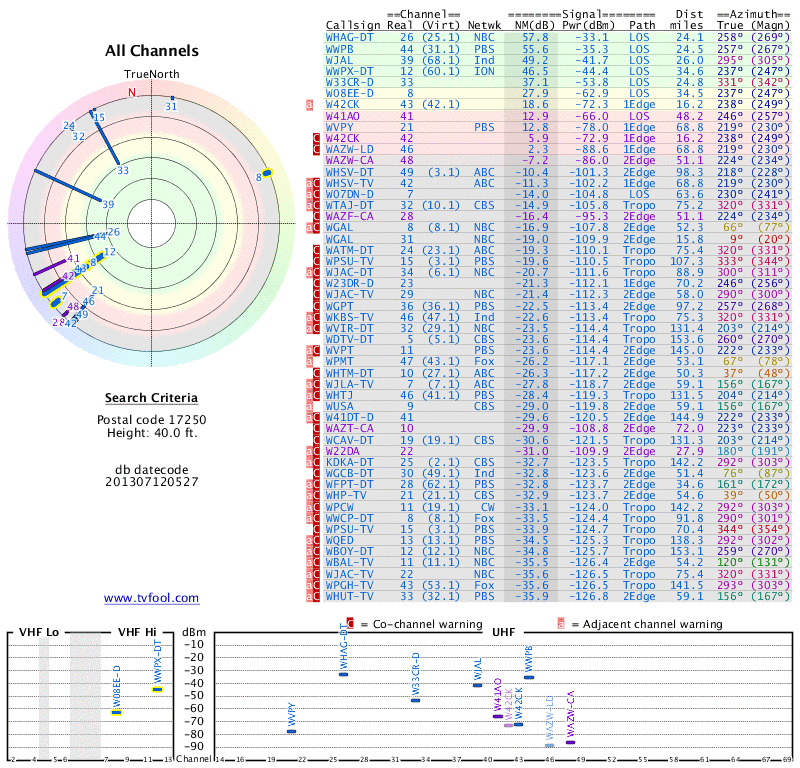

If you can post your TV Fool report in this thread, a bunch of people on here are really good at figuring out what you should be able to get for stations.
My setup currently is a cm-3020 antenna with a channel master 7777 pre amp on a 40 ft tower and im using rg 6 cable and an antenna rotator...my zipcode is 17250...not sure how to put a link from tvfool on here...im using my phone cause im at work right now...if someone could look at my tvfool report and tell me what channels I should get it would be greatly appreciated.
Posted your Tv Fool report for you below, there's an awful lot of grey stations there, meaning very weak .... with a 40 foot tower and fringe ant, good pre-amp and rotor, you've already got quite a good setup, not anything more that I can think of that you could do to make that better really, unless you gang a few antennas together.

Let some people on here look over your Tv Fool report and maybe someone will have an idea or two, are there any stations in particular that you were hoping to get?
I was hoping to get wvir channel 29 and wdtv channel 5...they are over 100 miles away tho so that may be out of the question...I got mountians to the north and to the east blocking the channels from Baltimore and dc...but the 2 channels I mentioned are to the south and west so I might have some hope...just looking for some idieas cause my rotator is broke so im gonna have to take the whole antenna set up down and replace it with a stronger rotator...while I have it down I was thinking of changing my set up to get more gain...
You are in my back yard. Way to many hills and valleys to use a generic zip code report. Run a report for your exact location and post a link.
WVIR and WDTV will not happen, just to far away. Based on the current report you are looking at a couple of PBS stations, NBC Hagerstown, ION and WJAL.

Right now the antenna spins around when the wind blows...I guess the bearings are shot in the rotator...when it was working I got all the channels down to watm channel 23 with -19 db on the tv fool list...i was wondering what is the lowest nm reading for a channel that I could pick up.
If you were getting 23.1 at 75 miles that may be as good as it gets, for UHF 24 that is pretty good reception.
Boba's right, that may be as good as it gets, that is pretty good all ready. You can figure it out, theoretically you need an NM [noise margin] value above zero after adding/subtracting gains/losses from your ant, splitters, etc, to receive a station. The only gain you'd add would be your antenna gain, not amps and such, you'd subtract all losses, such as splitters. etc.
It looks like WTAJ is right at the edge of what you'd possibly receive. Your ant. gain for UHF is 9.5 db, WTAJ's NM is -14.9, so still -5.3 NM and below zero before figuring losses for splitters, long cable run, etc.
