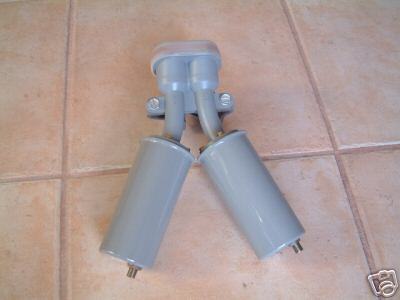

I assume the picture is what the dish & LNB's looks like?
LO for those (actually any SC LNB) is 10750. You have the capability of aiming at 2 satellites at once since the "beer can" LNB's are 4 degrees apart. I'd use the one on the Right (as shown in the picture...when you are behind the dish it will be the left one) for your "main" LNB as it looks at the sweet spot. The other one is offset a little bit. But you can still get 4 degrees apart :)
in the picture, yes it would be since that is aimed at "the sweet spot" on the dish
But the cool thing is if you are on G11 (91W), the left LNB would be almost at AMC3 (87W) so you could get the stronger signals at the same time :)
