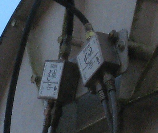

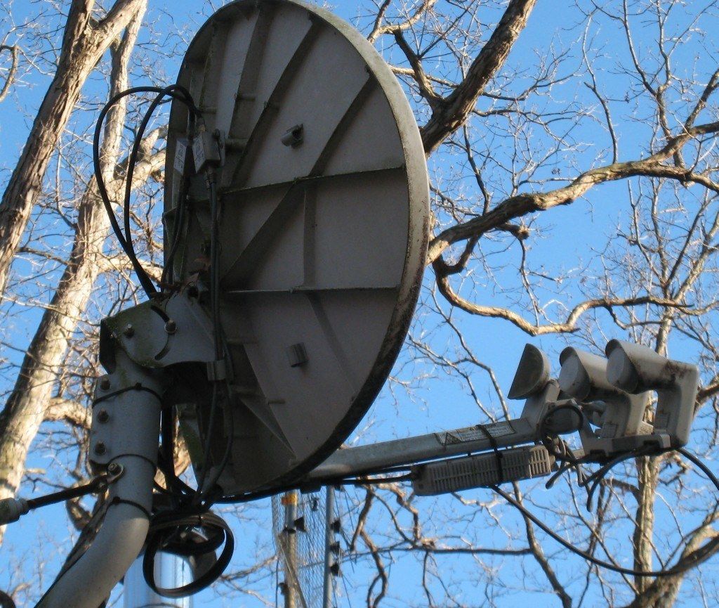

Pictures of the Starband Dish and Dish components on the back are attached.

Yes you could add a second dish pointing at the 129* to that set up. To do it you would need to swap out the LNBs on the Starband dish to Dish Pro LNBs (If the aren't already). Then using a third Dish Pro LNB on your "wing" dish, and a Dish Pro 34 switch. You will need to run a cable from each LNB to the port on the switch, and then the output of the switch will each run one tuner in a Dish receiver (IE single tuner one line. Dual tuner two lines). If your 129* LOS location can get all three birds it would be much simpler to just get a 1000.2 dish, and be done with it.
