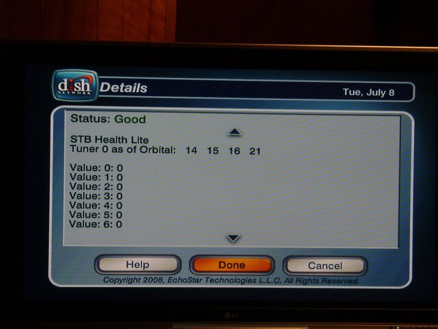

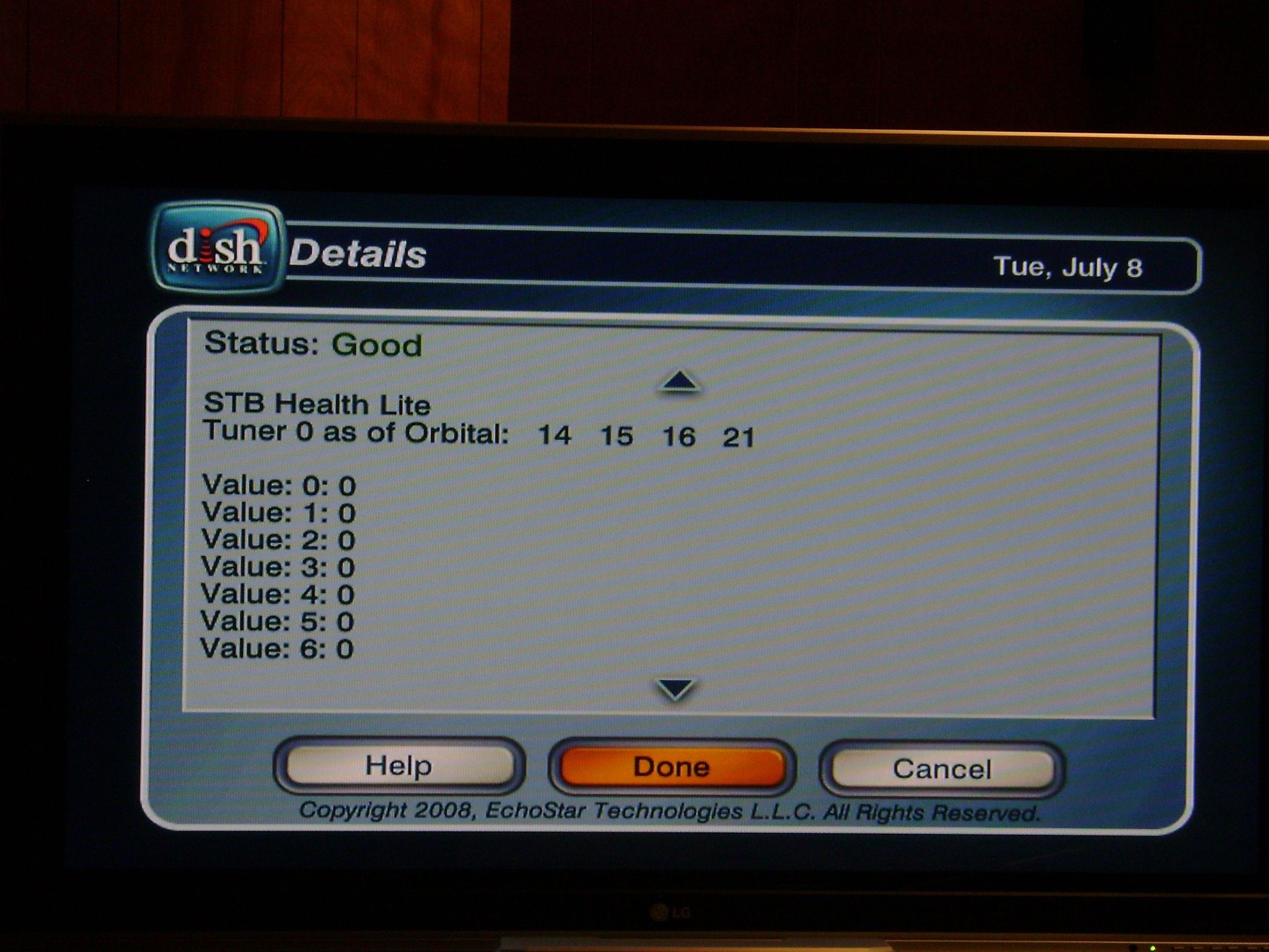

This STB Health Lite has been there on the ViP 211 since L4.39 update.
My 211 says Tuner 0 as of Orbital: 14 15 16 21
Value: 0:0
Value: 1:0
Value: 2:0
Value: 3:0
Value: 4:0
Value: 5:0
Value: 6:0
Value: 7:0
Value: 8:0
Value: 9:0
What do these mean?

Picture will be better, but anyway - after first line you should have some numbers for each tpn [14,15,etc], "value" does show historical values.

Do the orbital numbers refer to each sat (119, 110 and 61.5) ?
The value numbers on mine (0 thru 9) are all 0. Is this good?

Here's the picture

Now I see ... Something wrong here. Let me make my, there are missed sat numbers and signal levels. I think your SW doesn't work as need. Perhaps a bug in it.

Looks like Darrell S and dpr in this thread see the same as I do, on different STBs.

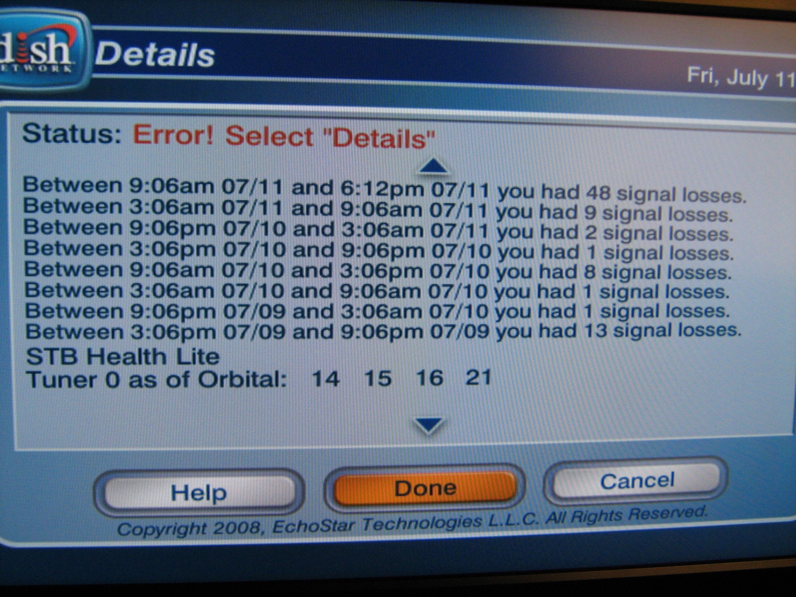

MY 61.5 is dead
Looks like its just another way of saying "LNB Drift Detected". Whenever i run the system setup 61.5 fails, it has had 48 signal losses since 9am this morning.
Waiting for tech to arrive....

Then I doubt if it is LNB drift.
I had a similar problem and it was a misaligned dish.
Service tech should help.
D
dpr
Member
Jun 12, 2006
12
Atlanta, GA
yep you were right
nearby tree blocking signal, was in the 20`s
they moved the dish farther back, now getting between 50-57 signal strength
