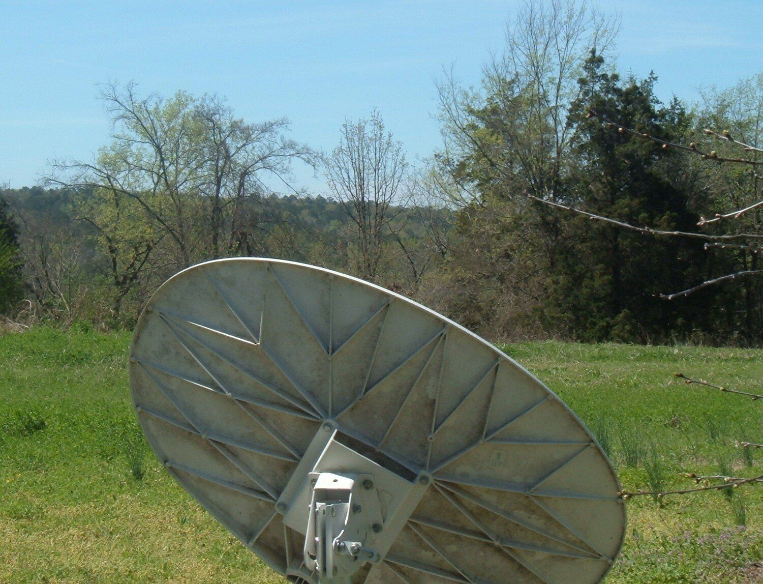

Well I guess I am going to have to put the dish on the roof. I was checking out the site today and it looks like the tree's are getting the signal. I have taken a picture below to show the tree's and their relation to the dish. I was hoping I was shooting above the tree line but since I get no signal I can only believe that it has something to do with the tree's. Although I could get a chainsaw and have a lot of fun its just not going to happen :D
There is a optical illusion at play here. The tree's are approx 100 yds (if not a bit more) from the dish. The illusion is that they are much closer (the ground drops down from where the picture was taken and in it makes the tree's look much closer than they are).

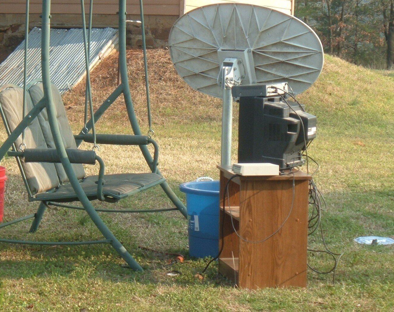

The 1st picture looks more like what the dish should appear with the 35.1 skew. The 2nd picture of the dish looks wrong for the 35.1 skew, but you have the right equipment to find the signal if you put the skew back to 35.1. Then with your elevation set to 38.3 and your azimuth set to 226.8 you need to have the nuts loose enough to move the dish while you look at the receivers quality meter on the tv. And your receiver needs to be on a live TP. Try these two: 11805 H 4580 (V-110,a-111;v-112,a-113), 12114 V 4444 (v-37,a-48 this is scrambled but there;v-38,a-35), you can find these and more on lyngsat. Hope this helps, just stay patient and they will come.
Al
Thanks, The first picture is from today. The second picture was from a few days ago (I had not set the dish then). It was on there pretty much to show my testing rig.
I have moved the dish (fanned the dish) but still no signal. Thats why I am guessing that it is a obstical issue. I can get a 90 on the signal quality meter (for like a split second) then it goes away. Thats why I am guessing the tree's are interfering with the signal (winds blowing the leaves or what not which is blocking my signal).

If those trees are a football field away (100 yards), I find it hard to believe that the trees are an issue. I could be wrong, but I don't think so. You just haven't found that sweet spot yet. It's there, somewhere.
Al
300 feet away them trees would have to be HUGE!!
38 degrees is what my TS is (IA6) so those trees would have top be like 400 feet tall to have issues :)

Thats pretty much what I was thinking but its the only thing I can come up with to explain what I am running into. I have tested all of the equipment and the wiring (with the exception of the LNB). I know there is a signal out there (and I have a good idea as to where its at). Its not difficult (or so I thought) to point the dish at the Az. I should be hitting something (unless my elevation is off).
