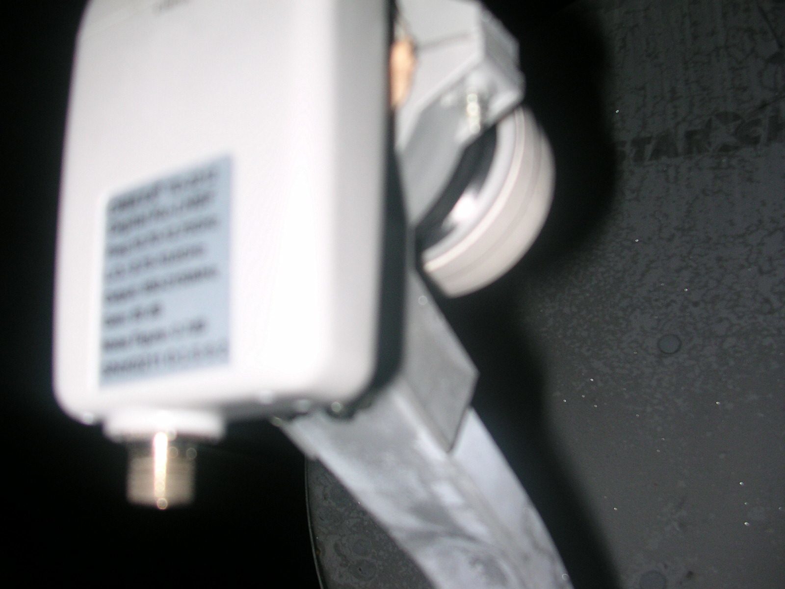

not sure about LNBF skew (rotation) and if i should use Universal 1 or 2
lnb used-- lnb-Ku Band Universal, Dual polarization, single output LNBF, which adopts the wide band technology, can receiver the signal of frequency range: 10.7~12.75Ghz. The two L.O. frequency 9.75Ghz/10.6Ghz (or 10.75Ghz) can be controlled by the output signal of 0/22khz or DiSEqC from the receiver, at the same time switching the polarization by signal of 13/18V. This LNBF is wide band, high gain, low noise and resistance of shock

LNBF skew, depending you at east or west coast, that the LNBF set at 4 or 8 o'clock position. I believe you use universal 1.
NO matter, you set the LNB L.O at 10600.
Skew setting is by turning your LNBF to the left or right, since you are at central of Canada, LNBF straight down is just fine.
