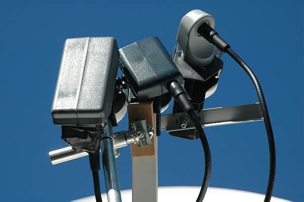

I use it in a modified form on my setup. Was pleased with the results I got with it. I didn't try it "as is" to see what results I could get.
Photo 1: (L-R) Echostar7 (119), G10R (123), IA7 (129)
Worked very well to get Echostar7, easy to point and lock in, though it helped that the LNB placement was so much lower than G10R.

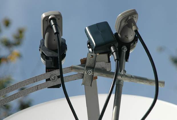

Photo 2: (L-R) AMC3 (87), IA5 (97), AMC4 (101)
Was a bit harder to point and lock in due to how close it had to be to IA5, and with all the various positions and adjustments to handle. Of course, it would have been easier if I was standing on the ground, instead of on a ladder and leaning over and reaching up to make the adjustments!
