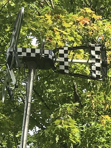

My goal is to get the majors ABC 7-2, CBS 9-1, NBC 7-1 , FOX 9-2 and PBS 27-1 having no troubles getting the 9s. I use a tablo so i can record and playback show but i do have a direct hookup to the tv to compare, same reception on both. i have run just a short pole and tried both a spectrum rotating antnnes
and the 1 BY ONE ufo antenna

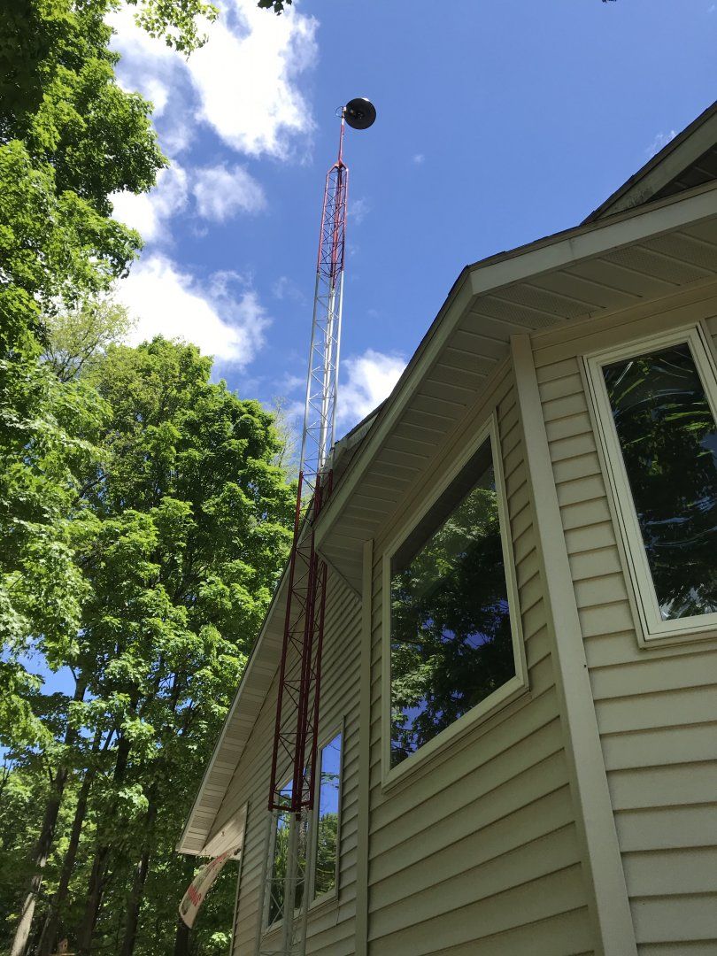

June 5th I put up a 45' tower that is 25' above the house peak. I put the 1 BY ONE on the very top.

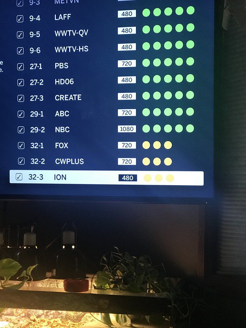

Looked really good. 27s seemed to come in good, 7s were touchey. So today i thought i would remove all the excess cable. they had it run to the back of the house to the electic meter and then back. So i cut about 140' of cable out and put the ground block and the base of the tower screwed to the tower, no ground rod yet though, then i ran it directly to the little amp. Now 27s are weak and 7s are bad if they come in at all. rescanned and got this
I didnt update so i can go back and try the channels, but they are weak if they come in at all. i rechecked the ends i installed, they look good but they are just crimp on type. I will have to hire a bucket truck to work on anything now. I cant even spin the pole i installed down the center, i guess i got it too tight and i painted everything. first step will be to loosen it up so i can turn in form the ground. then when i have the bucket truck try going back to the spectrum.. I also left a loop in the coax up top that i think i will remove just in case.

Height is the best friend of OTA reception and you have already done that with your tower.

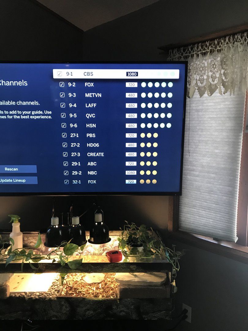

update. first thing this morning 7 June i got 20 station and they all came in, by 10 am the 7s and 27s started to deteriorate. i can probably safely go up another 15' if i can find a tower section and a michgan supplier that can match the tubing i used down the center. even this may not clear the trees as they are very tall but it will be close. wish i had the drone to see how much higher it would take.
