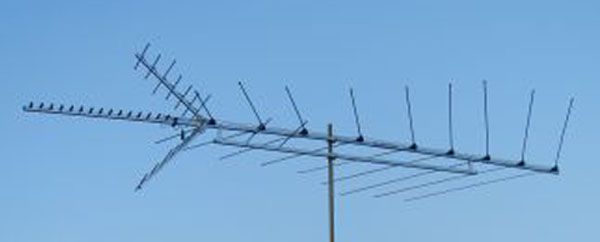

channel 28 in Scranton operates on RF11 so I assume you have a VHF antenna?
160" boom, 57 element, VHF/UHF/FM antenna.
Reactions: foghorn2
We had one of those when we lived in town. BIG but nice antenna. Finally took it down after constant comments from neighbors - 'do you really need something that big'. I stored it in the carport and bought a smaller one. When we moved to the country a few years ago, went to get it out of the carport and it was gone. Apparently it wasn't too big for someone around there and they helped themselves to it (One of many reasons why we left town).:rolleyes:
That's a shame. I had installed one at my best friends house several years ago and when he passed away last summer and the family was getting ready to sell the property I asked if I could have it. So I now have spare parts out in the shed, including the rotor and pre-amp. The only problem with the antenna is that the plastic snap clips that hold the long elements in position get brittle and break. You can work around it, it's just annoying when it happens.
Sorry to hear about your friend. Yes, same thing happened to ours - one of the clips broke while it was still up and then a few more when it was taken down and folded for storage. Like you said, could have worked around it if I still had it.
