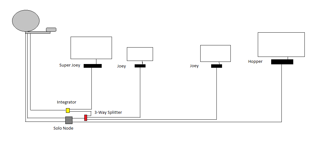

This is how you would wire a 4 TV house with a Hopper, Super Joey and 2 Joeys.
We were thinking swap an existing Joey for a Super - move to 1 Hopper, 1 Joey, 1 Super (believe it or not, we have timer conflicts with 1 Hopper and 2 Joeys). But I notice it says RG6 from integrator to Super Joey. I think the Joey requirement is RG59 - if we don't have any problems now, can we assume existing Joey cable will be ok for Super Joey?
It won't work via LAN only as the tuners come from the sat feed.
You may be right, but your statement does not logically follow, since the coax input probably functions just fine with a DPP switch output. In other words, I was asking whether you could substitute the LAN for the MoCA (only) connection.
I know you can have RG59 from the Node to the Joeys but I still prefer to have RG6 run to everything in the house. Just seems to avoid more issues that way.
