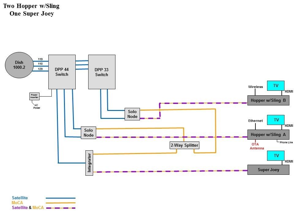

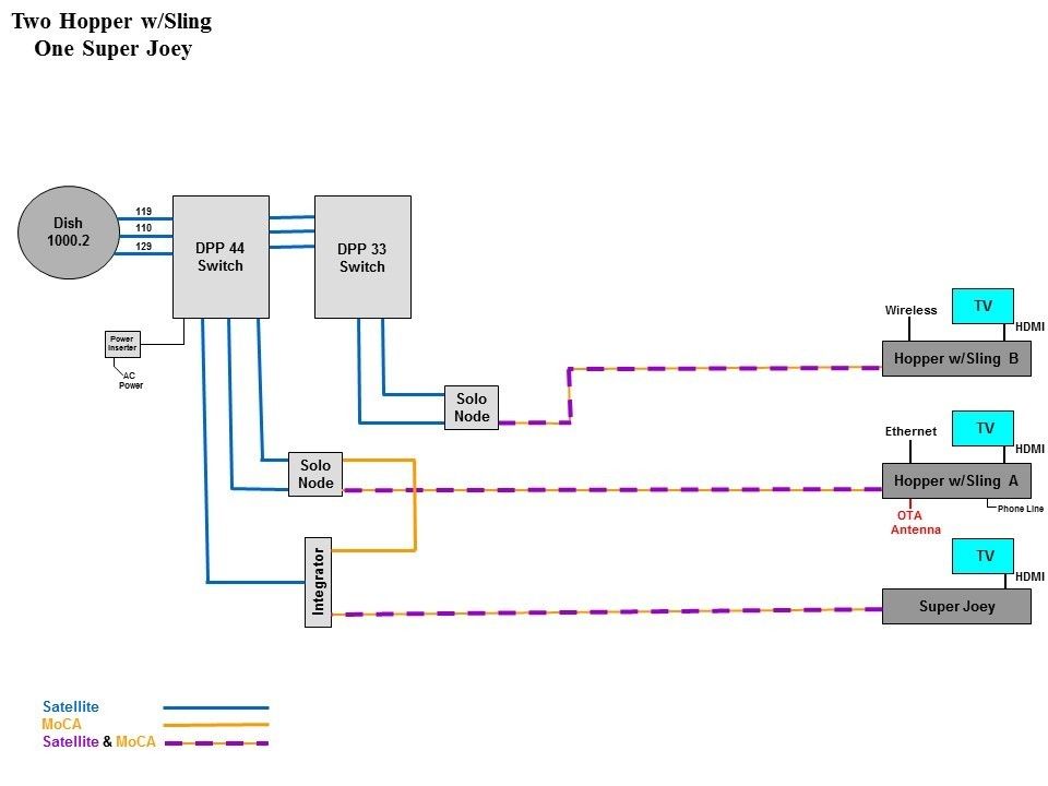

If Dish were to actually allow a Super Joey with two Hoppers how exactly would it get wired? The way it has to be wired now doesn't allow for a second Hopper. There would have to be a switch I believe.
Yep on the switch. This would work.
The biggest obstacle to the 2H/1SJ proposal would be Dish's policy. Currently they won't allow a SJ on any account with more than one Hopper. The only way around it would be two accounts.
