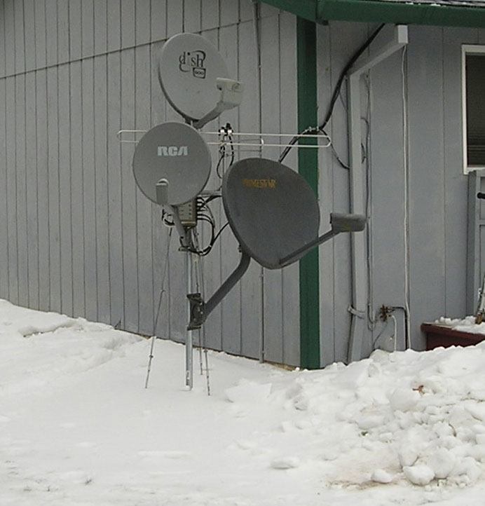

What? I have exactly that setup with a primestar dish with multiswitch
feed to a sw21 for 4 sat. Maybe I'm lucky but it's been running for almost a year.
