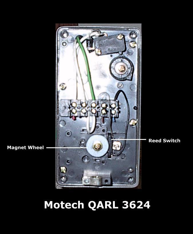

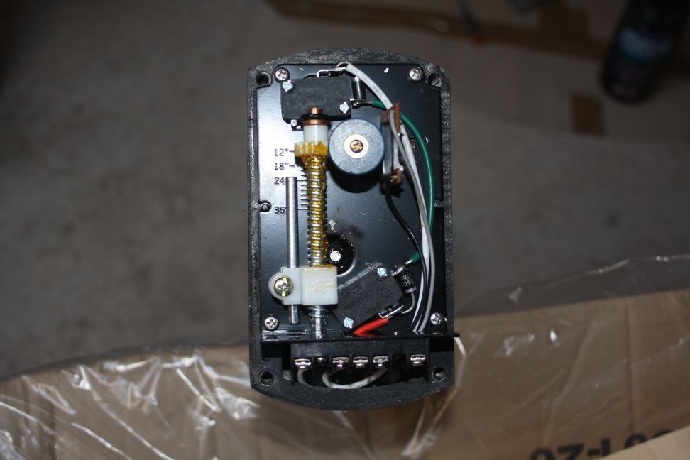

Look at these two pictures, they both have the same model name SuperPowerJack QARL-3624 but they differ enormously in quality inside as you can see, guess which is the cheap one?
The one on the right is the higher quality model as you can see it has a real limit switcher and metal backplate.
The cheaper one have cheap plastic limits with a plastic backplate and a real cheap plastic cable connector, also the cable insert on the cheap one does not have a proper cable insert thru the housing but a small cheap rubber insert
Also you can see that he higher quality version got a real gasket and thicker metal housing.
