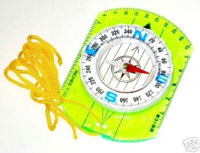

If you can provide your zip code, we can tell you where you need to look with the aide of a $12 heading (map) compass you can get at any Wal-Mart, Target or outdoors store. It is real simple. Unless your current 101w (standard) dish has a real tight LoS (view) then you are likely going to be fine, but for $12 and 5 mins, why not check it out before you call and set anything up.
