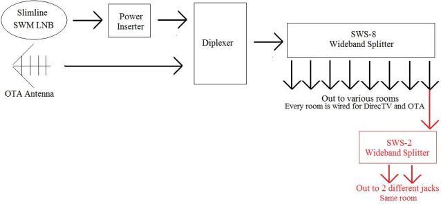

see attatchment

I could be wrong but don't you need two diplexers. I had to use two with my setup, one on each end or it wouldn't work.
I want to use one line with SWM and also backfeed on the same line. The Picture looks like you would be running 2 satellite receivers? Like the Previous post, I would assume you would need 2 Diplexers to use the single wire as a Sat Feed AND a backfeed?
