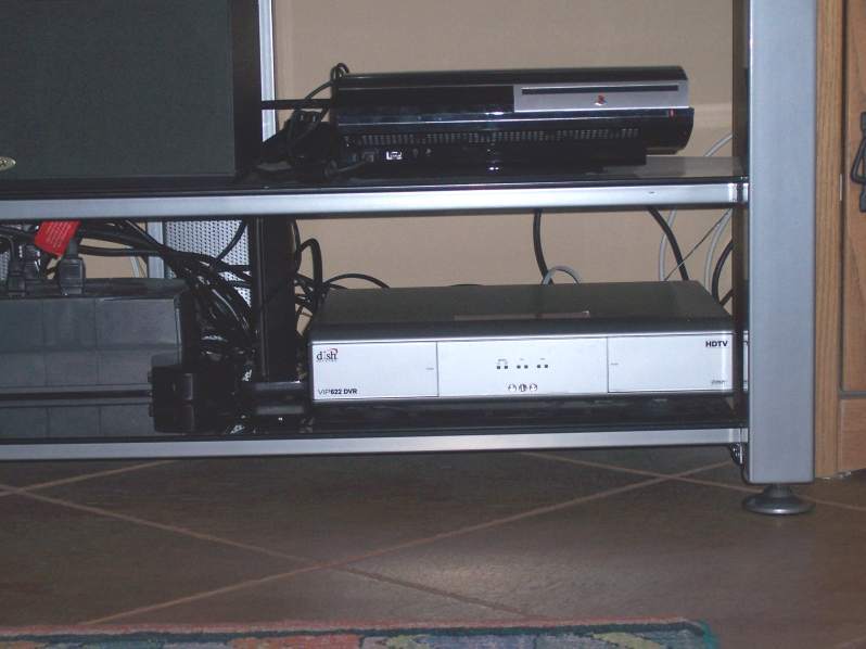

The 622 is in an open cabinet with plenty of air circulation (see attached picture), but the room temperature was around 79 degrees both times the incident happened. I put my hand on the 622, and it felt hot, but I don’t know if that was unusual or not. I think I’ve read on this forum that 622’s tend to run hot.

Looks like the right side of the 622 is butt up against the side of the cabinet... that's the intake side for air... you may move it inboard some to allow the fan to pull in more cool air.
Also, mine has plenty of space for air intake, & it began to pixelate a little more than it used to, but never got to the point of rebooting like yours. I took the cover off and took a can of compressed "duster" & blew the dust off the fan blades & chips while holding a vacuum to suck up what I blew off... no problems w/ the pixelation any more... may be worth a try, they're extremely sensitive to temperature...
Good point, tempVAdish.
I have moved the 622 to the left, allowing more airspace on the right. I also moved the EHD away from the left side, again allowing more airspace.
