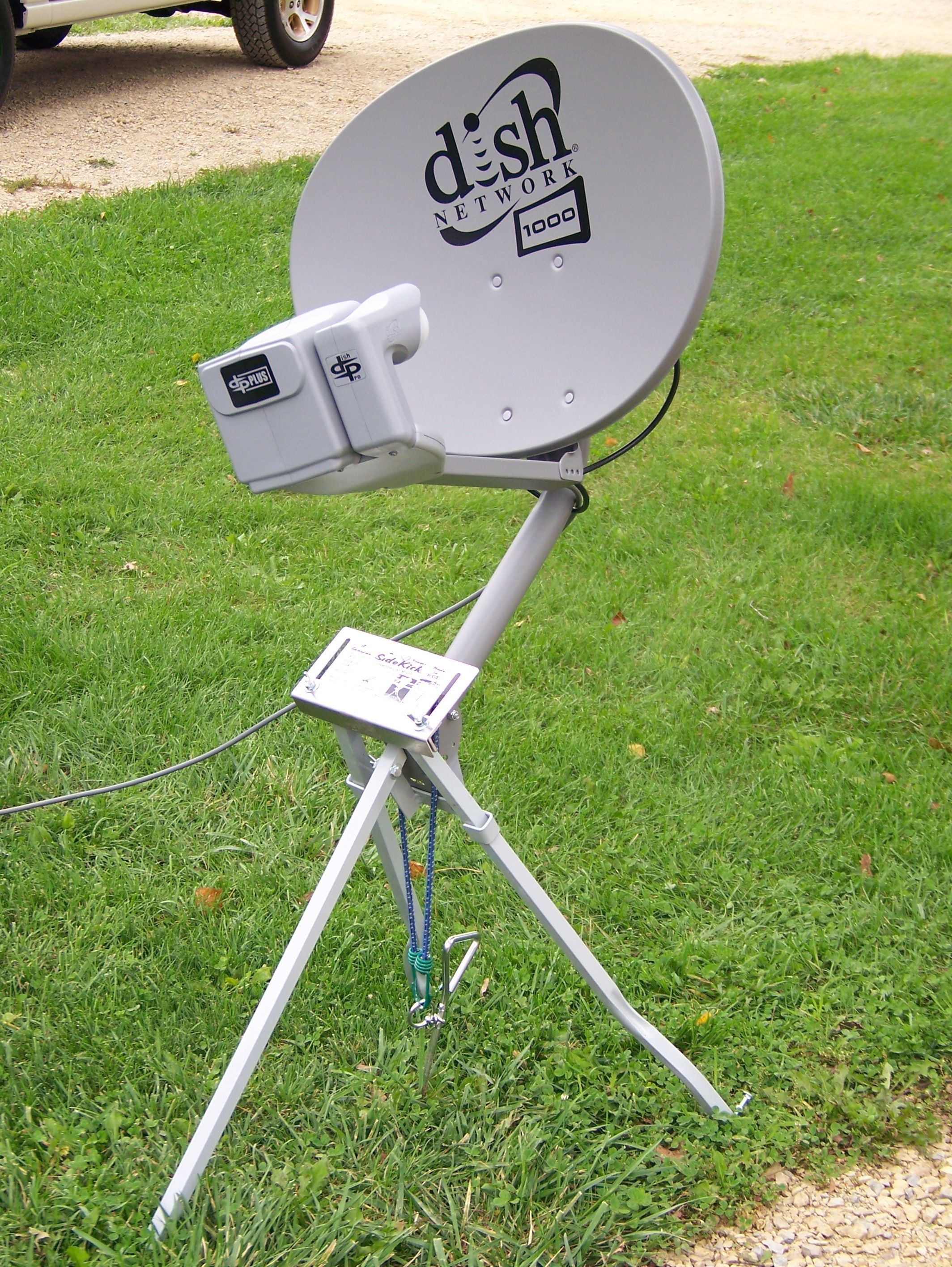

I use the sidekick when camping I found it to be the best and easiest
to set up for the price of your Wineguard on e-bay you can buy the sidekick
which you can mount a anysize dish which has a larger footprint then your 8"

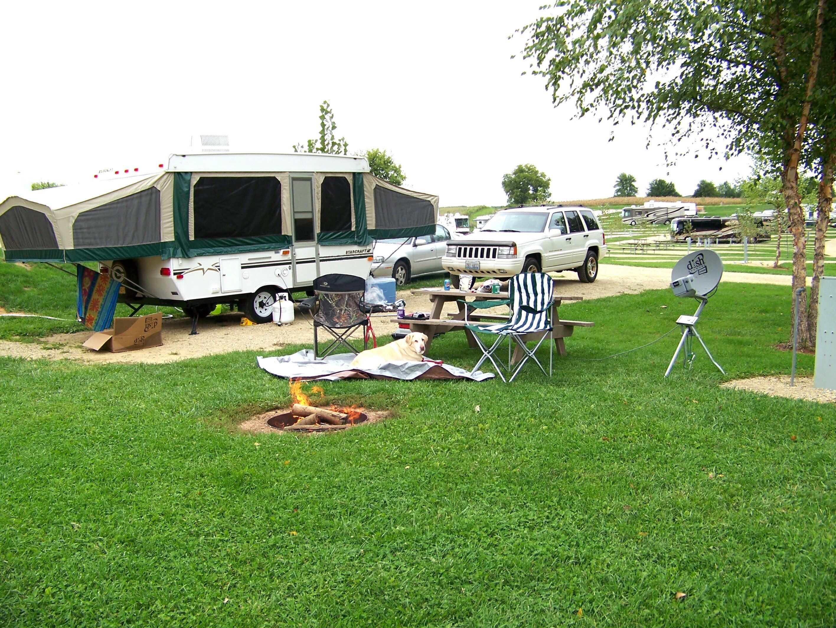

I've installed a Dish 300,500, 1000 and a DirecTV oval three way on it
I presenly use a Dish 1000 on it and hit all three sats within minutes I always draw a crowd when I pull out my dish!
