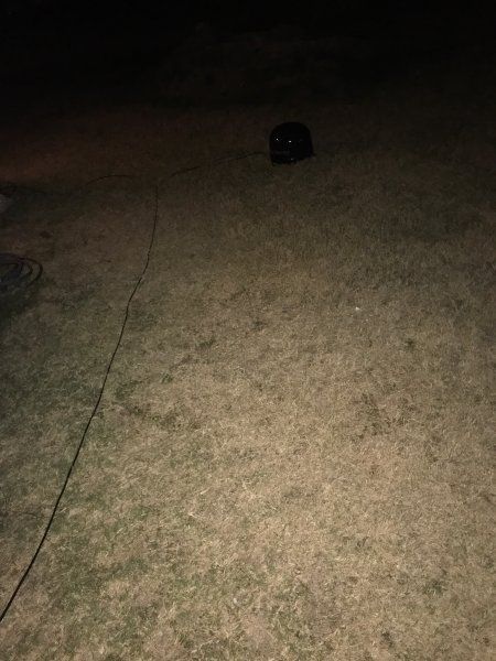

The receiver connected to the main output controls the dish movement. The receiver connected to the aux output can watch any channel beamed from the satellite the dish is currently locked on. Instead of the previous single lnbf, it has a Legacy dual lnbf installed.

Can you PLEASE tell me how you got both on one dish satellite. I have the playmaker dual and no one at dish can tell me why my other receiver isn't working. They keep telling me the second output on the satellite is a dummy and doesn't work, but all over their website says the dual can connect 2 different receivers. WTH....

Have you tried calling Winegard? They make the Playmaker...

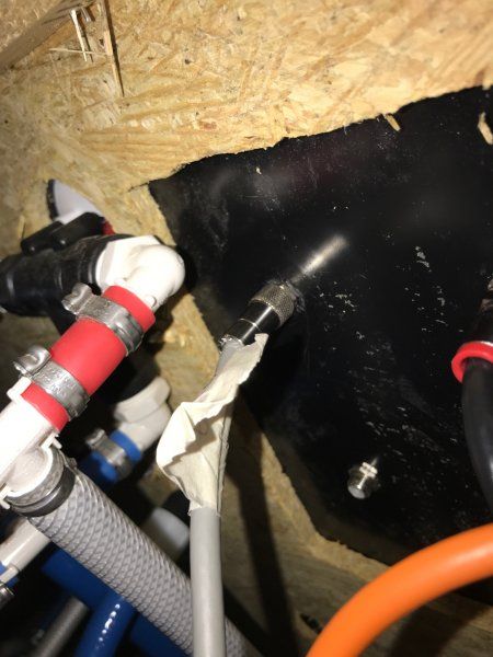

If you're having no problem with the primary receiver, then it's most likely just that the 2nd receiver doesn't have the right satellites saved. Keep the 2nd receiver in the spot that it's been in, but unplug it from power. Move the RG6 between the RV and the Playmaker, so that the cable that is coming from the 2nd receiver spot is plugged in to the 'main' spot on the Playmaker. From there, plug the 2nd receiver into power and let it go through its setup. After it asks you to pick your state, it should go to a screen that says "Please wait while your switch installation is checked, currently doing test # of #." The 2nd number should not go to a number higher than 4. If it goes to something like '2 of 38', then there's likely a wiring issue specific to the line that feeds the 2nd receiver spot.

Once it's all set, restore the RV to Playmaker cabling back to where the primary line is going to the 'Main' spot on the Playmaker, and the secondary line is going to the 'aux' spot on the Playmaker, then let the primary receiver do its startup.
