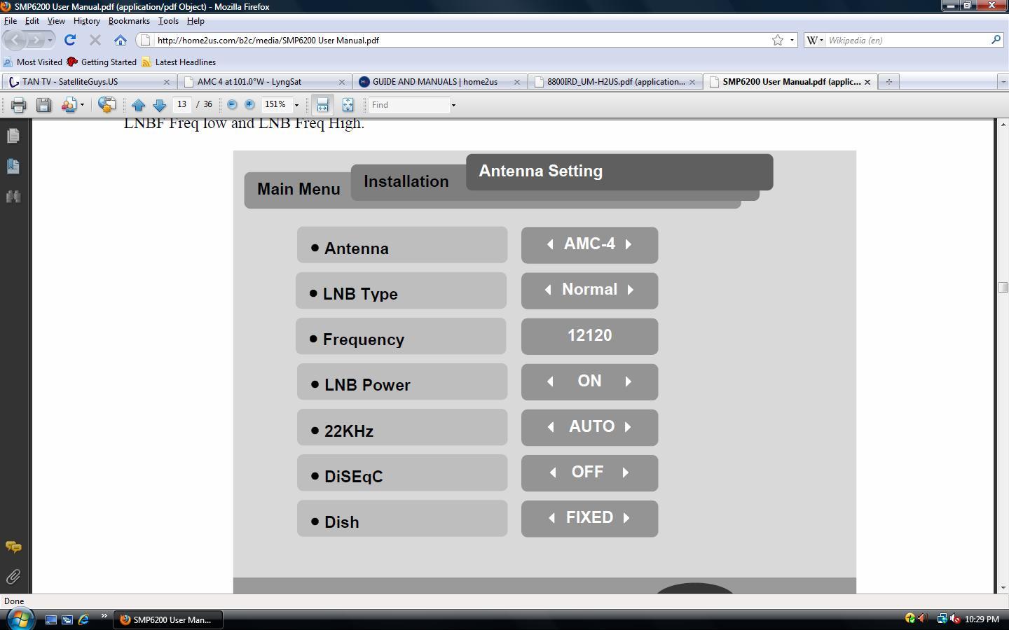

6200 guide see attached picture below
here is where to get the pdf's of the manual
GUIDE AND MANUALS | home2us

noticed on their site they sell a dual LNB antenna for 97 & 101
That's good news, I should maybe have him call his dealer in Wisconsin and see what they would charge to do an upgrade. I guess they're happy enough with the service, but might be much happier with all those free channels.
