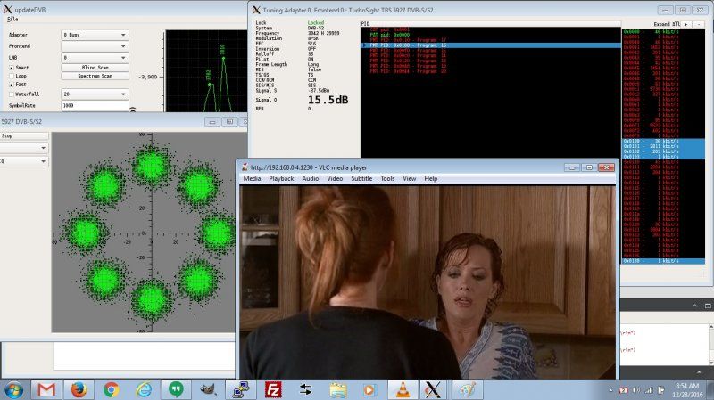

I wanted to respond to this separately. I really wish you or someone would create this and make it work on systems that do not have a desktop, such as the server-only editions of Debian or Ubuntu, but make it VERY user friendly. I've heard that there are a limited set of tools out there now, but they either require a the installation of a desktop, which you really don't want if you're just running a server such as TVHeadEnd,
Not really. X has been client/server since its inception in the 80s. I don't have an X server installed in my tvheadend box, in fact it doesn't even have a monitor. Just install an X server on whatever remote device you want to use for display, then when running X clients on your Tvheadend box have DISPLAY configured for the system with the X server. Your X client(nowadays some may call it an application) will be running on the Tvheadend box, but remotely displayed on whatever you install an X server onto. Free X servers can be had for about anything, I have them on Windows and Android. In the photo you can see that I am using a Windows notebook, but have X clients displayed on it.
