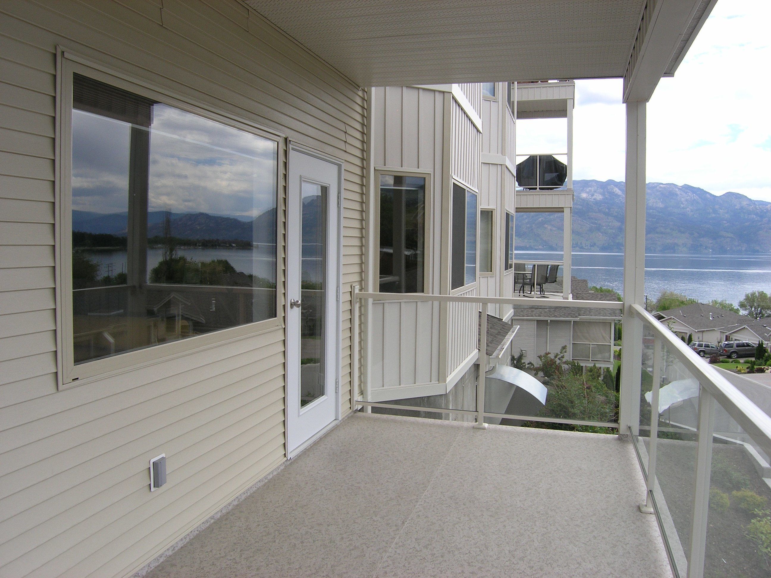

E* will not visit to do a LOS. I am on the first floor of a three story condo building facing West. The South view is limited by the building extending approx 100 ft.
Picture is South view.

110, 119, and 129 will all be west of due south for your location. If your picture is due south you have a shot at all three of the satellites. 110W should be around 230 or so on the compass I would guess. Go to Satellite Finder / Dish Pointing Calculator with Google Maps | DishPointer.com and enter your address to get your angles and points. You can mount the dish to a tripod and the tripod to a concrete paving stone and put it on your deck/patio if they won't allow it to be strapped to a patio rail. You can also poll mount the antenna into a 5-gallon bucket of concrete.

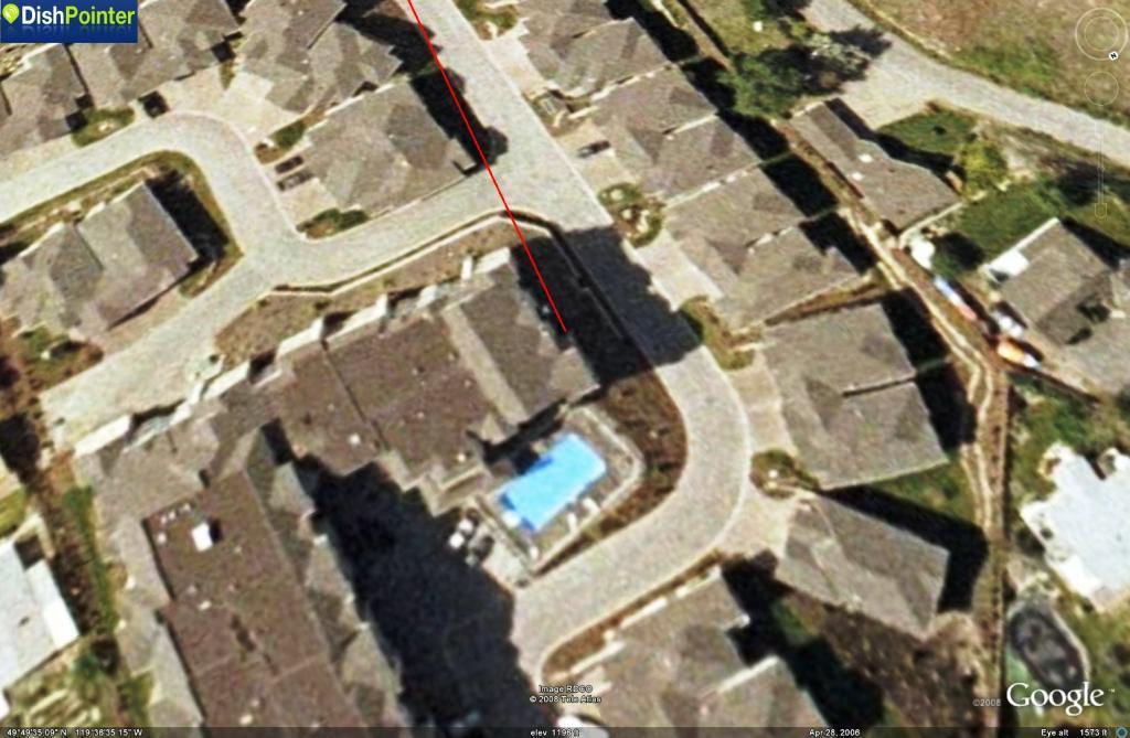

The LOS line for the 1000.2 goes down the west side of the building as seen in the first picture (not due South). It was iffy. I then had an installer try to get a signal to no avail (we strapped the dish on a post temporally)

This picture from Google Earth is 1000.2 LOS and is not due South. Due South LOS runs down the west side of the building.
