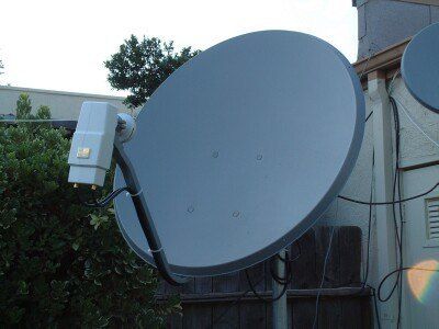

I got my new QPH-031 LNB today... So I removed the
dish/dtv and the offset fta lnb's. Mounted the 031. My dish arm
was strong enough to carry the 1.5 lbs lnb, so
that was one problem I missed. Than I ran it through the
same switch I had.
All the Echo sats (110, 119 and 148) went from the
80's to 99!!! T-5, T-6, Mexsat, G10 and others (Im still
scanning) went from a low 30's to 55 or 50's to 70's.
And some I gave up on also came in strong enough to
bother with....
BTY it's a 30" (ish) dish a 2100 rotor and a Pansat 2500A.

One was a DMS .5 the other I have no idea, it just and old
dish/dtv one with no case on it... I also re-made cables
that might have helped a bit..
It does look a little "top heavy"....
