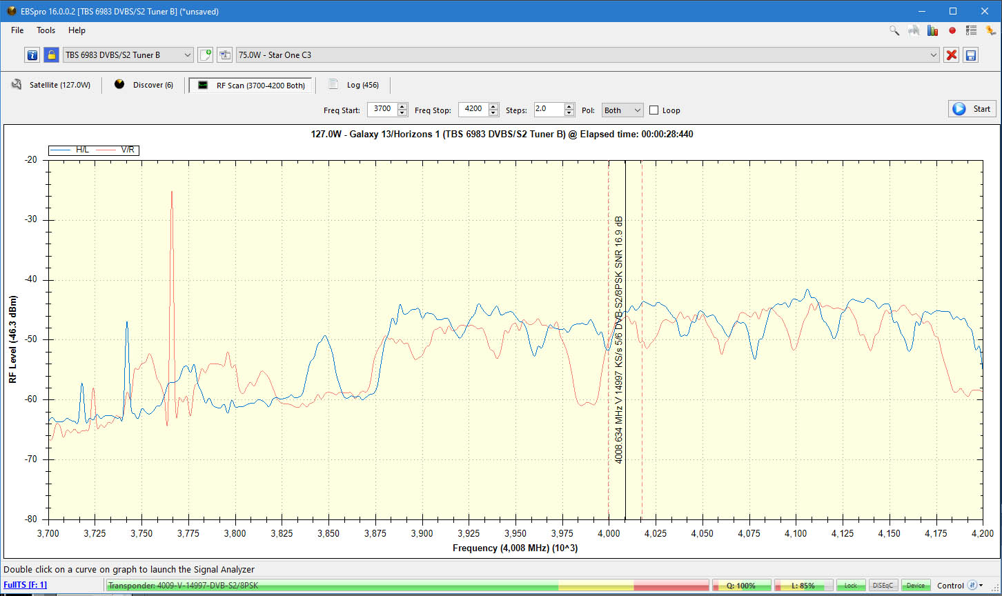

An EBS Pro scan shows that 4008.6 V on 127W is coming in at 16.9 dB which is excellent. Yet my Edision OS Mio does not show it when I do a transponder scan. A regular channel scan doesn't get NASA TV either.
Below is an EBS Pro screen shot showing that 4008.6 V is being received at 16.9 dB. But when I do a service scan on the same transponder it displayed "ERR" (2nd screen shot below).
