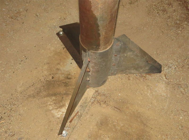

Several months I found a BirdView dish that came with a triangular pedestal base like you described (photo below). I like it because if I ever have to move the dish I can just unbolt it and not have to dig out a metal pole.
They don't make these anymore, but maybe someone here knows of something similar, or it might not be hard to build yourself if you have a welder.

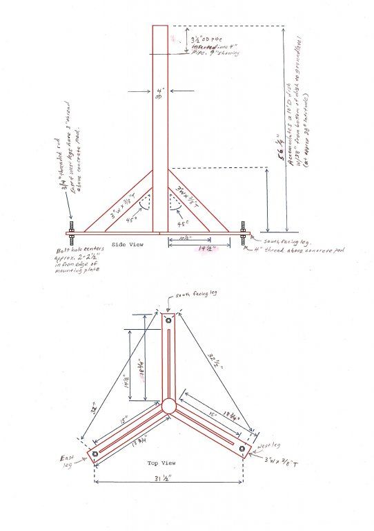

I drew up a quick plan sketch for a dish I plan to install late this fall if I can find the materials... still looking for suitable mast. This design uses three cement piles 12" X 9' to be below the frost line up here.
Just for idea sake. This mast assembly is for a rather heavy commercial 2.4m offset dish. I'll be using 5/8" threaded rod buried into the cement piles...
Reactions: JFOK

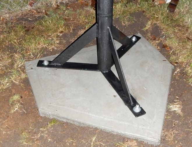

Thank you for the compliment!
The bolts are actually 3/4" steel threaded rod (i.e., stronger than all-thread). Under each bolt location, the pad has 3 piers that extend down to rock (>36"). After the concrete for the piers/pad had cured for a week, I set the dish mount to mark locations on the pad. Then drilled holes 12" into the concrete and, using concrete epoxy, epoxied the threaded rod into the holes and let that cure. It was the longer way around, but everything lined up.
I'm fairly certain the mount is locally fabricated- it came with a 7.5' dish I retrieved a year ago. Dimensions of the mount in the photo below.
