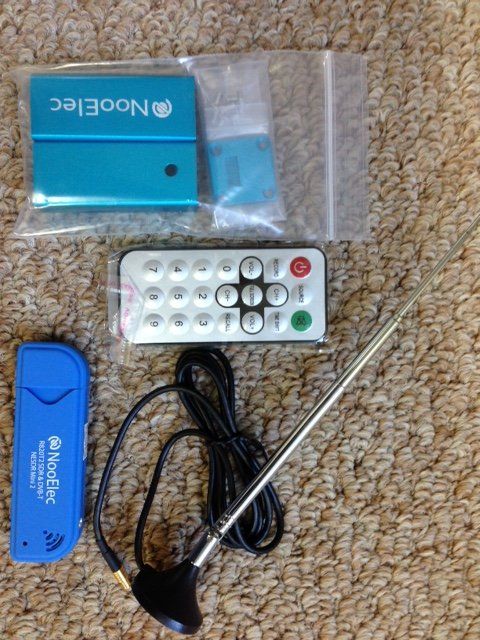

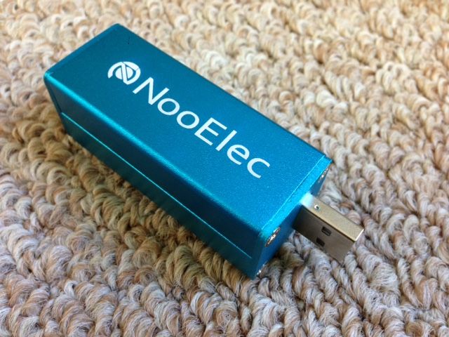

My NooElec mini 2 DVBT dongle and aluminum case arrived today. The frequency does seem to be more stable, but my original was pretty close and linear. Not seeing any significant difference on the sensitivity when A/B switching. Tried to match the base noise level by eye and compare a few carriers throughout the frequency range. The biggest difference was when I removed the plastic case and installed the tuner in the sweet aluminum case. The noise floor dropped noticeably.
The antenna is now a 6 section, 18", telescoping with swivel and magnetic base. Looks to be slightly more useful length than the shorty stubs supplied with most dongles.
I will be a little more technical in future testing, but quite happy with the new model and the case! I have ordered another case for the original dongle as it certainly looks better than my tin foil RF shield wrap... :)
