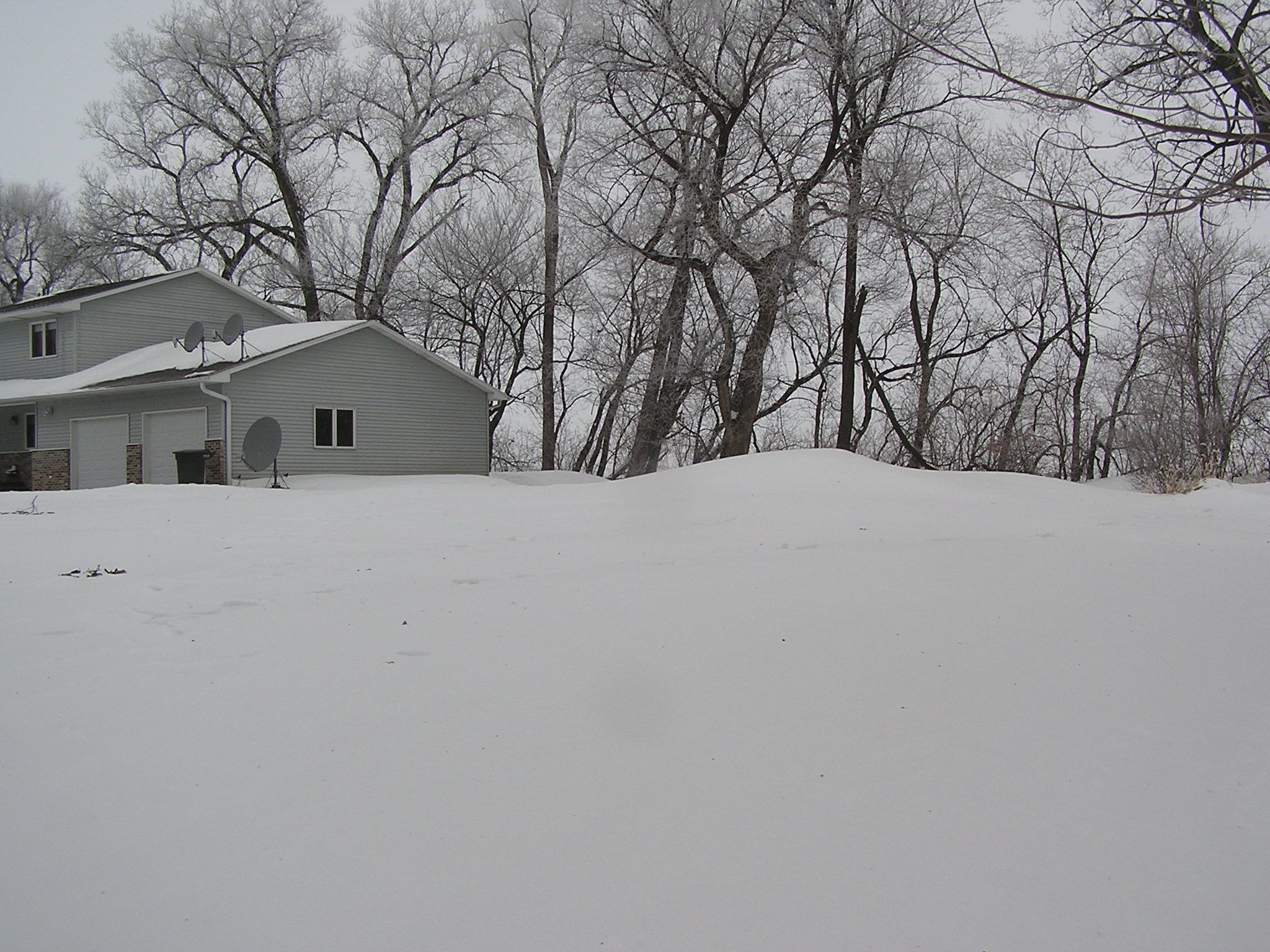

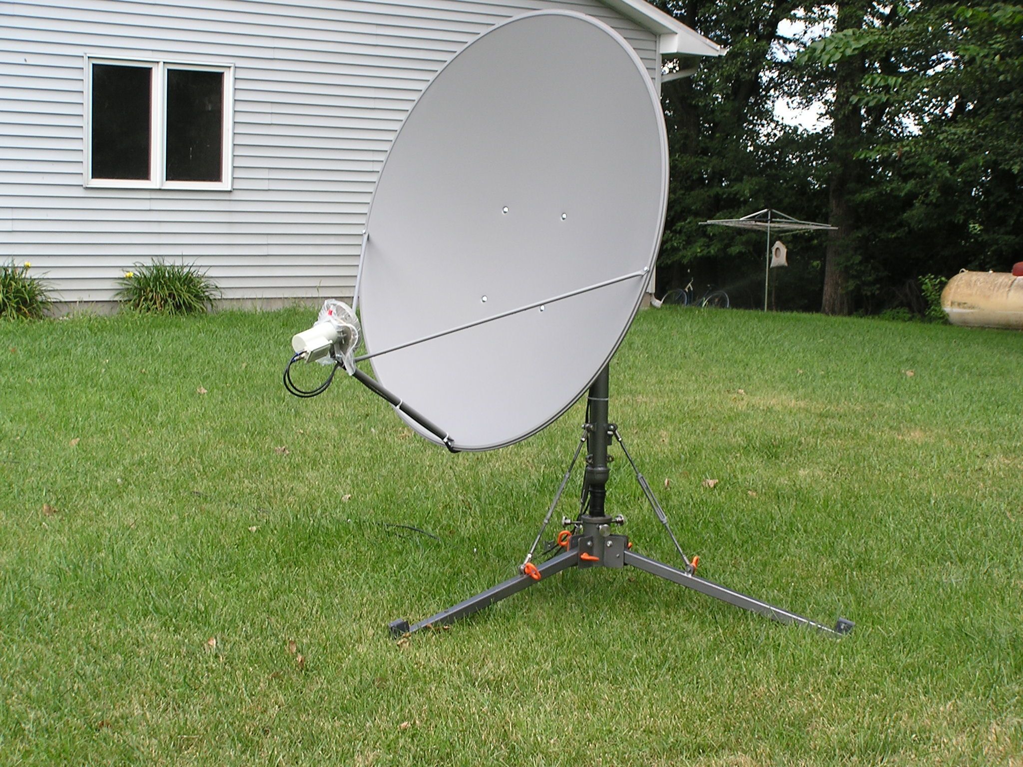

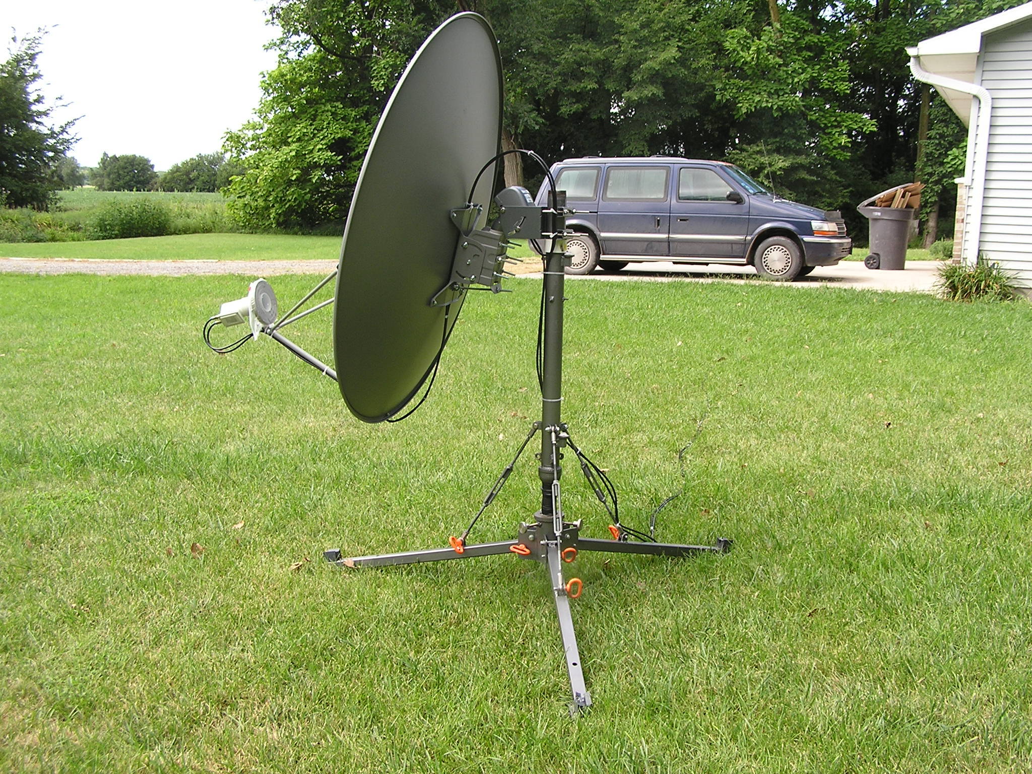

I walked around the yard today searching for a better spot to install my dish this Spring. Unfortunately the best spot has a 6 foot drift extending all the way back to the tree line. It is located about 90 feet east of the garage where I had the dish setup last fall and gives me a clearer shot at satellites 133-139W over the trees on the west side of the property.
I attached photos I took last fall of the dish setup 90 foot east of the garage, and one I took a few minutes ago of the drift which is the small rise in the center of the photo. My lot drops in elevation about 4 feet from the house, the drift in the photo is actually about 6 feet deep and would have covered the top of my dish had I left it there. Never had this much snow before that you had to worry about digging out your dish. Maybe I will take down the 76cm dishes from the garage roof and install the 1.2 meter in its place.
