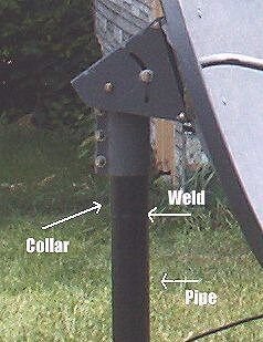

If you need a larger diameter pipe one can always make a collar and bolt or weld it on. Did that with 2 pipes, work's well. Here's a picture of my Primestar pipe I modified for 3"
