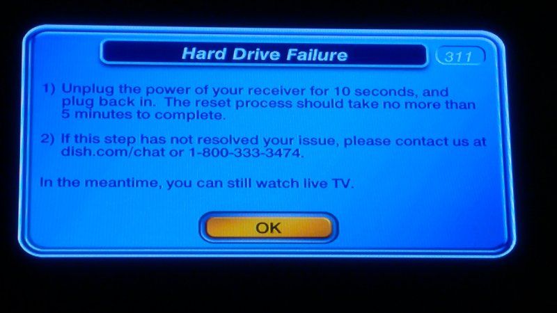

The replacement receiver arrived yesterday. Since I work late shift, I didn't get a chance to install it until about 12:30am this morning. The replacement receiver has a bad hard drive. How do I know? Because it TELLS me it has a bad hard drive.
1) I get a 024 error when the receiver starts up telling me I can only watch live TV
2) I get a 44 hour guide, not the 9 day guide
3) In the diagnostic/Analysis (Menu 6-3-) the hard drive test is grayed out.
4) In the System Info screen (Menu 6-1-3) the hard drive icon is X-ed out and in red.
And when you do a receiver reboot (either by plug pull or holding down the power button) the receiver will come on to a point, then do a second reboot (not normal) before it comes up with the 024 error and comes on as a non-DVR receiver.

That is incorrect. # 3 and 4 do not display that on an out-of-the-box Hopper. You also don't have to wait 24 hours, overnight, etc, etc in order to be able to pause live TV, rewind, record, etc.
