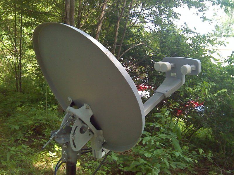

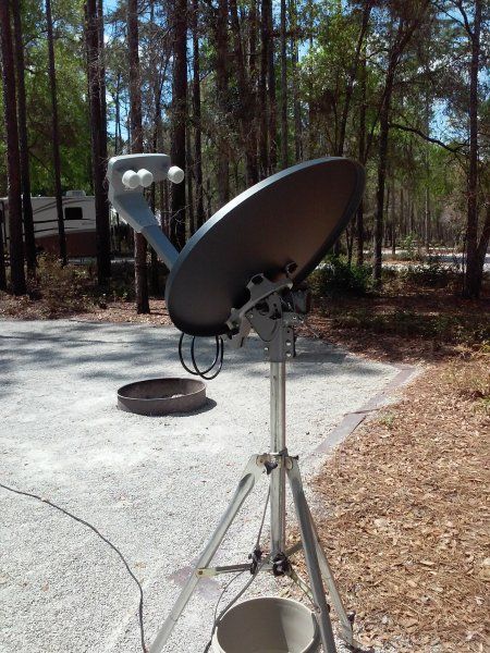

Just to confuse the issue a bit, as a very mobile RV'er, I have a 1000.4 dish that I switch LNB's between EA and WA as needed for the best LOS and/or to get the locals for the area. At times, having the capability to receive the 77 sat on EA has made the difference between getting the locals or not when the tree cover only has a big enough hole for the 72.7 and the 77, but not the 72.7 and the wider spaced 61.5.

Check the photos. Both are EA triple LNB's mounted on 1K4 dishes. They both still have three LNB's and the spread between the 61.5 and 72.7 sats is still obviously larger than the spread betwen the 72.7 and 77 sats. Just two different styles of caps on the 77 & 72.7 pair.
