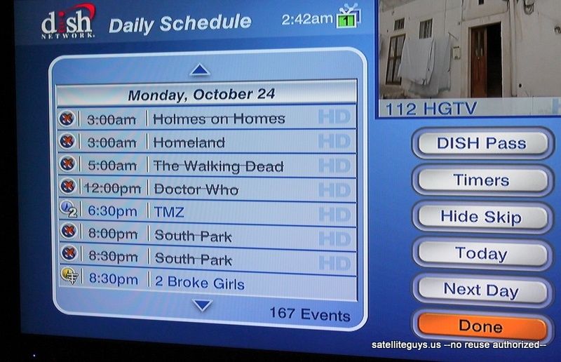

Not sure which receiver you have, but try this. Press the DVR button 3 times. That should bring up a list of scheduled recordings. You should se the list of recordings. Arrow over to that list. There will be an X in front of recordings that are to be skipped. If the program you want to record is X'd arrow down to it. The reason will be listed at the top. If you want to record it, pres Info and arrow up to Restore and select that. The program will now be recorded.
the basic reason for why it was skipped is there... sometimes more detail is in the Info screen where DWarren is describing the "restore" button is also available.
Are you at the screen that says "Daily Schedule"? That shows what is scheduled to be recorded or skipped. The X would be before each skipped recording. Otherwise, it will show which tuner is scheduled to record.

When you press the DVR button on your remote 3 times, does it take you to a "Daily Schedule" screen?
If so, anything that is setup with a timer will be listed there for the current day. If the item has an "X" next to the time ... this is an event that will not be recorded. You arrow over and up/down the list it will show you the reason why that instance is not going to record.
See the picture ... each X has a reason...
He might have the "Hide Skip" option enabled which would explain why he isn't seeing it.
