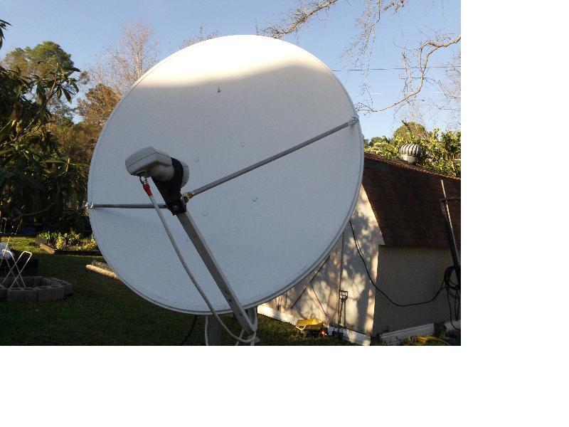

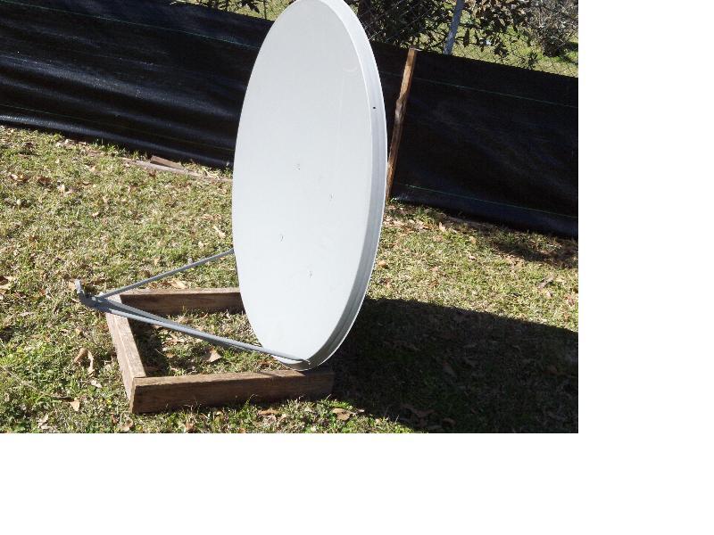

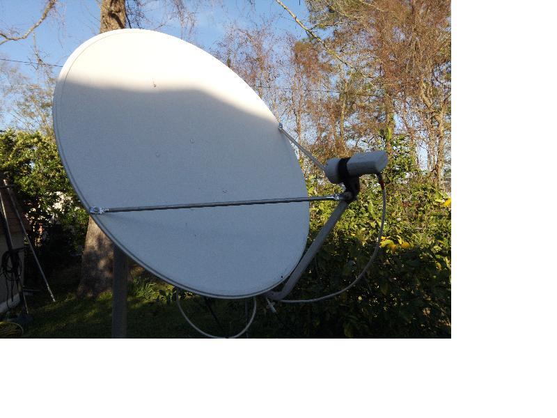

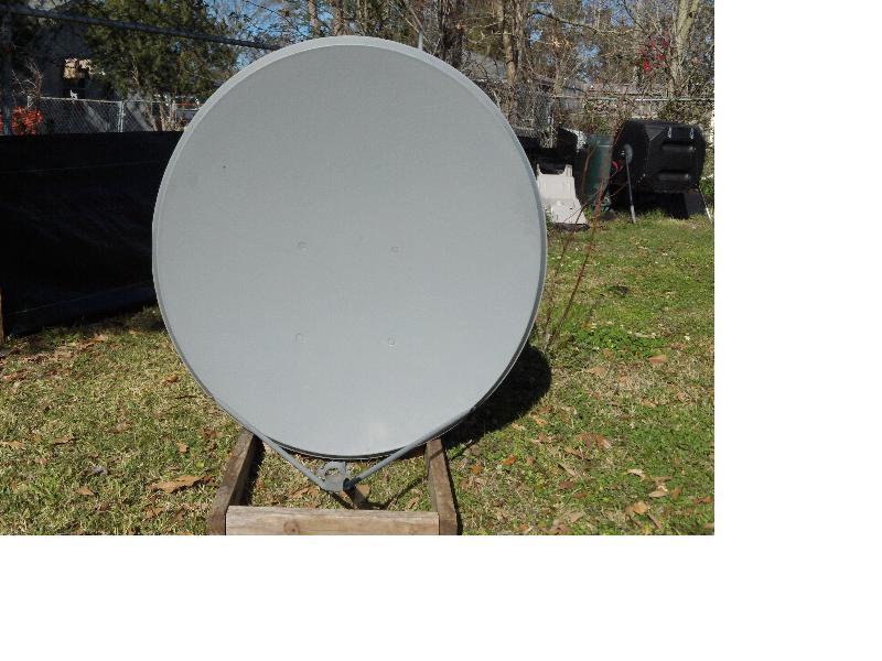

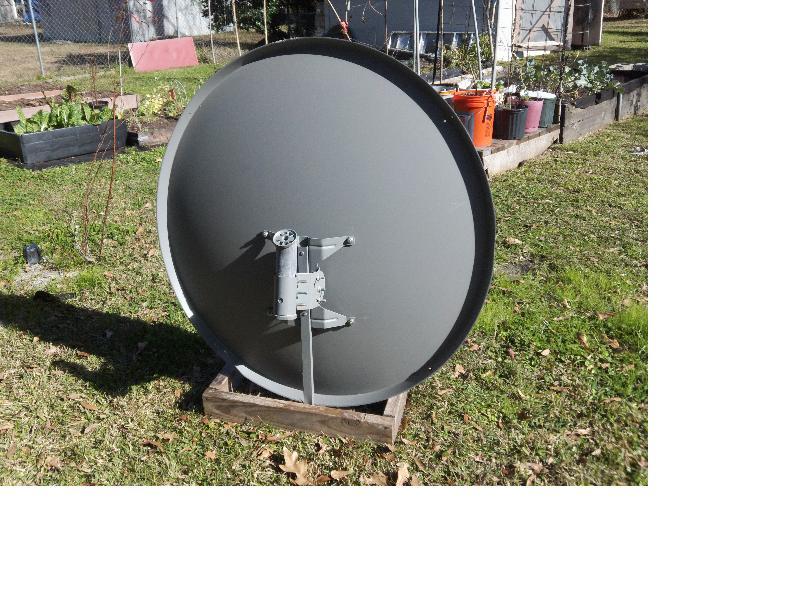

This is my first try to send pictures to the FTA forum. Included are some of the pictures of my new offset dish. Could not find a happy median with the bright shining sun.
The dish looks small in all three pictures, but this dish is large compare to my original KU dish. Can someone tell what brand or what company made it, if needed I can send more pictures, want to exercise my new found uploading technique LOL!!.

Brian, is that a desireable dish for KU band...Did you ever carried and sold that type of dish...My friend is running away from the Mardi Gras madness, when he comes back from vacation, I will ask him from whom did he bought the dish. I believe that, that dish and the other items were bought about eight years ago, as you can see it seems that he only buys good quality products.

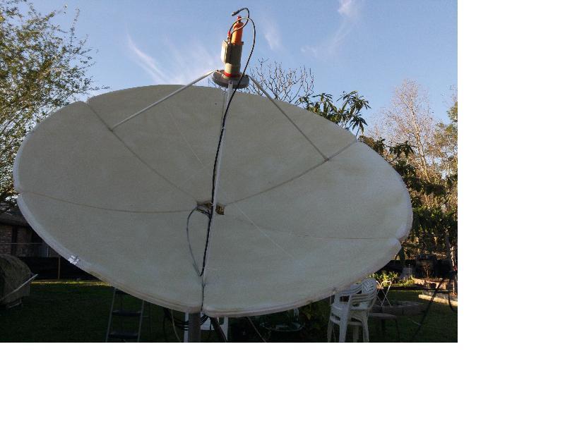

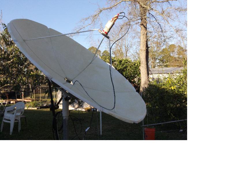

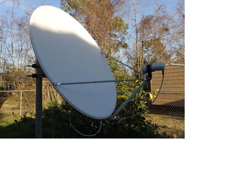

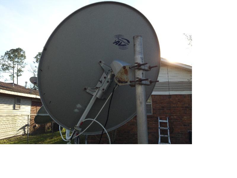

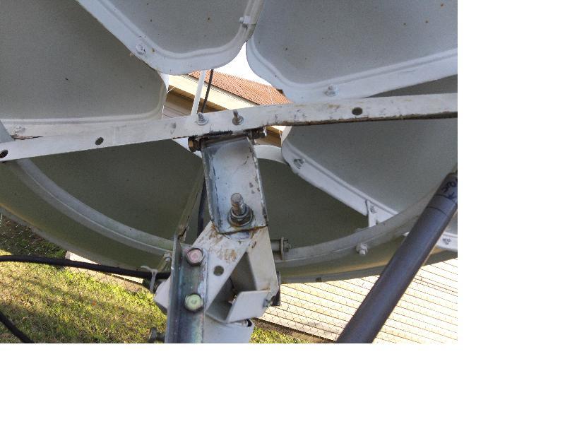

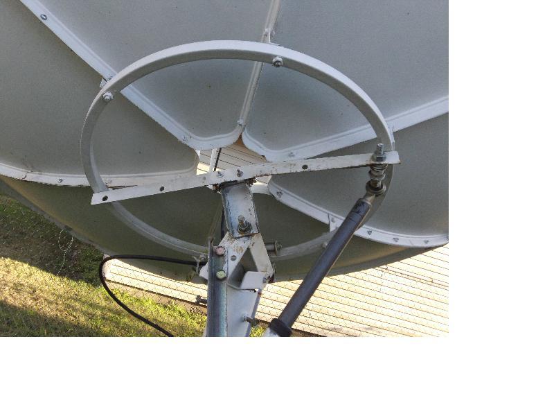

Anyway I took some picture of my two mini-farm dishes. The Ku (Satellite AV) was bought at about the same time that my friend got his equipment, and the other (the $69.99 special) has practically hit the dust, the only thing that is holding this thing together, is the two coats of spray paint, not knocking it down, at least for me, it has served its purpose.

Yes, the Winegard 1m is a very nice dish. Since it is steel, do a string test to make sure the parabolic is still true.
We only wholesaled several thousand of the 1m, but retailed 20k+ of the smaller brother, DS2076 (76cm).
I didn't dare to hope.
Not every day someone gives you a 1m Winegard dish. :)
I might suggest outfitting it with a PLL LNBF from SatAV.
The combined improvement of bigger dish & better LNBF might be impressive.
As for settings on the motor, I'd assume nothing.
The 30" version of that dish is known for superior performance for its size. Have heard nothing but good things about its big brother as well. You got a great dish there.
