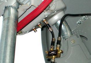

100_0837.jpgI just by passed the lnb part of motor with RCA splitter signals back up there, but motor still will not save sat position.
See pic.
Is that splitter rated for satellite frequency (2 GHz)? If it is a standard CATV splitter, it probably tops out at about 1 GHz, or 900 MHz. If so, it is not suitable for satellite use.
It is 900mhz and it works very well. I got a 2400mhz one and the RCA 900mhz works better then that one.
