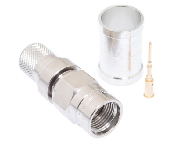

"Most F connectors on the market utilize a coaxial cable's solid inner conductor as the plug's center contact pin. This design can cause near and long term problems from center conductor nicks, bending, dielectric migration, metal fatigue and contact corrosion. Furthermore, this type of commonly installed F connector may also produce signal degradation, outages, poor picture quality, RF leakage problems and most importantly - an expensive service call.
To meet the growing demands of advanced Digital Broadband equipment, Canare has developed the world's first precision, highly reliable 75 ohm F Connector. Electromechanically stable (nickel over brass body, high quality tapped threads, extra wide torque nut, gold crimp pin, extra long crimp sleeve), our FP-C is quick to install using the same Canare strip & crimp tools as our standard 75 ohm BNC and RCA plugs.
Canare true 75 ohm F Connectors are impedance matched with excellent Return Loss characteristics and can easily handle future "Smart House" RF broadband multimedia networks to 1 GHz and beyond. Will mate with SCTE approved standard F receptacles."
and these are not new as they have existed for 23+ years since even what was said above was probably written 23+ years ago so there is a reason that people are still buying and using them but until one has used them, it's hard to say one way or another.
It could also because the tolerance in the specs is more tight among other things since it's no different that like if a connector is corroded, techs will generally just use elbow grease while others will use something like cramolin red or cramolin blue to deoxidize and remove the corrosion which is hard to explain until one actually used it as it does improve conductivity as well. Caig laboratories sells the same stuff as DeOxit. So maybe the better way to look at the investment is while both the approved list will work now, you have to look at it should there be problems a few years down the road so while the former might be cheaper, maybe spending that extra money might result in it being problem free. So there is no such thing as a 100% but 99.9% and maybe in reality, the extra money just adds more 9's after the decimal so you will get closer to 100% but ofcourse it depends how much one is willing to pay to be closer and it should be reasonable so maybe I should have said if the cost was only slightly more since it's obvious a bad idea to spend 5x to be better but if it was 5%-10%, it might be worth it and using 91+ octane in a vehicle to run on 87 is different because once it's burned, it's burned but in this case, your wire is still there so in the future, should the specs change and the wires still can handle the spec for whatever you need it for which could be satellite, cable or anything else for that matter, you can use the same wires without having to buy new wires again which at the end might actually cost more in total.

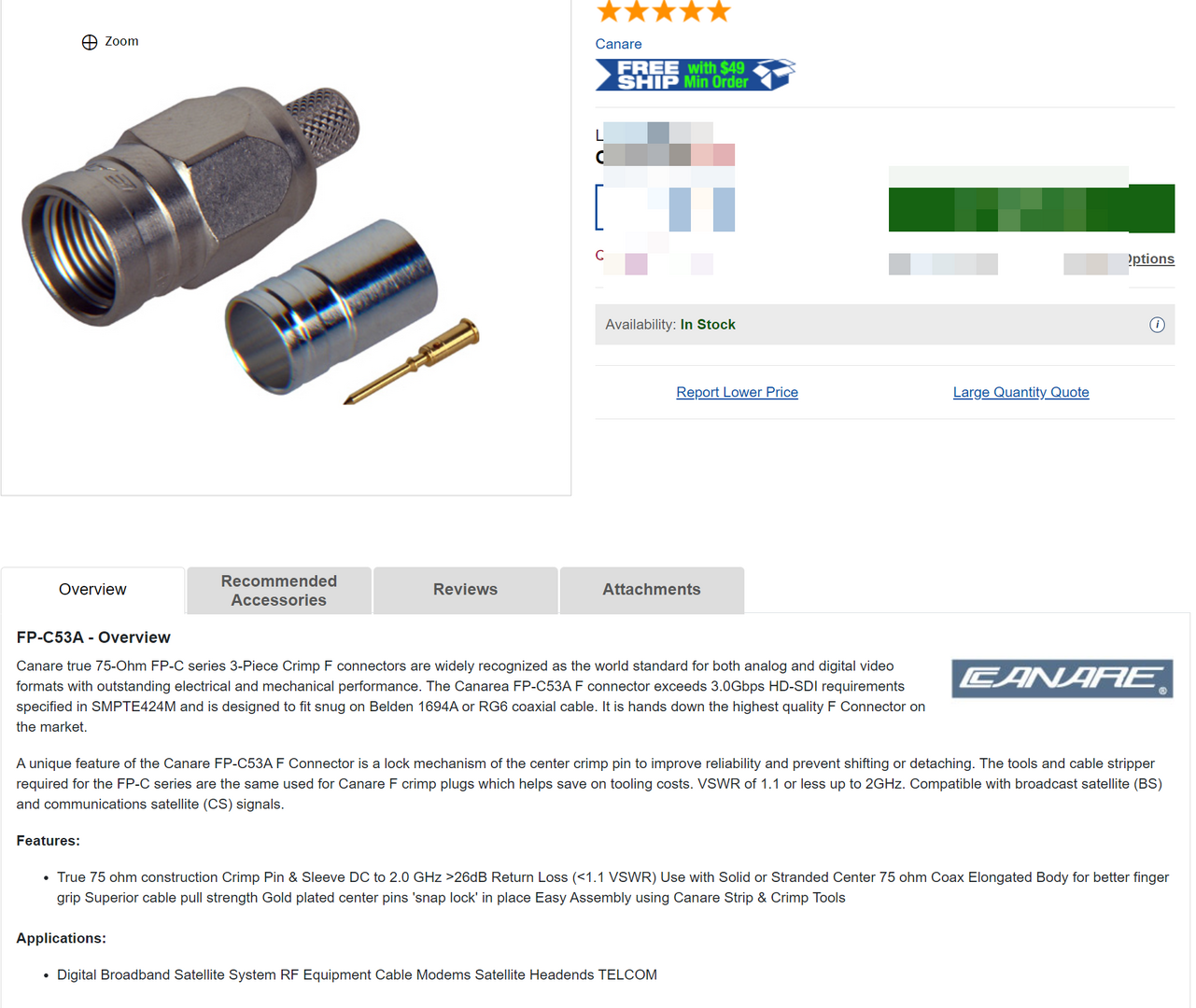

After thinking about it for a bit, this is what is shown on Markertek:
If you really think about it, it does increase the surface area because if you look at the pin, remember the pin would need to be bigger than the diameter of the copper conductor so basically pin is inside the female F connector, it will be a more tighter fit because it will be bigger in diameter than without the pin.
